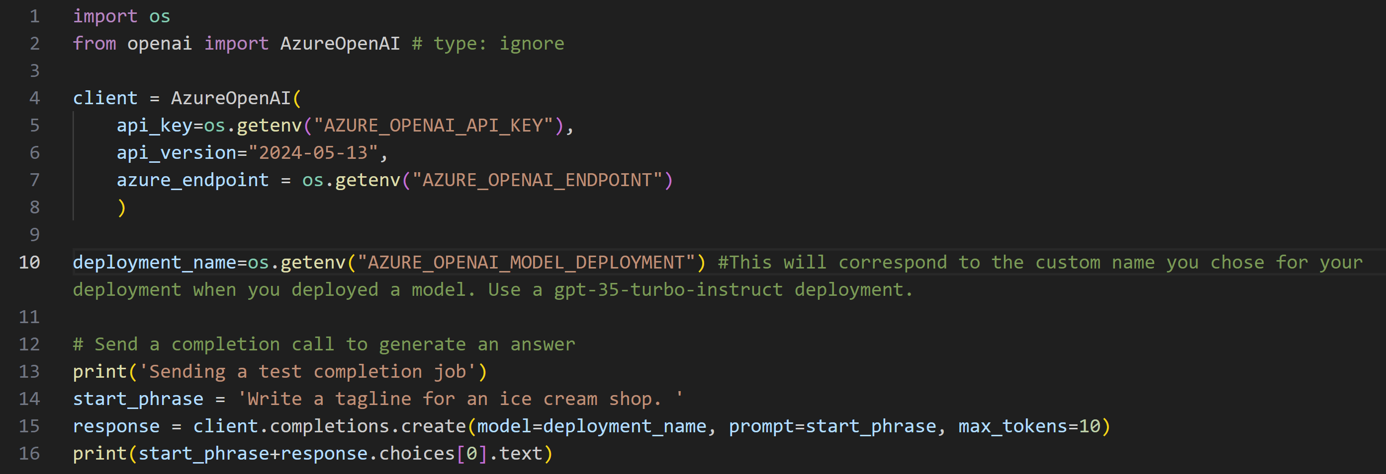

To simplify the issue, I tried running the example code on this page, under "Create A New Python Application", replacing ONLY the api_version with "2024-05-13" and the deployment_name with my deployment's name (NOT the deployment model, which is gpt-4o). My code is in the image below. Again, my environment variables (i.e. azure_openai_api_key and azure_openai_endpoint) are set exactly as the ones in my Go code, which has been able to successfully leverage Azure OpenAI.
setup_code
Line 4 raises the aforementioned httpx.InvalidURL error. I think if I can fix this error, then the other ones should fall into place, because the invalid character is likely causing the illegal header value (and reading an incorrect API key), which is probably to do with the APIConnectionError / NotFoundError.
    As you have mentioned, it is working fine with GO and facing issues with python version, could you try with API version 2024-06-01 which is the latest GA data plane inference API release.
    Another thing to check is whether the Python libraries require any additional configuration or setup beyond what is required by the Go code. For example, you mentioned that the Python libraries explicitly request an API version, whereas the Go code does not. It's possible that there are other differences in the way the two libraries are configured that could be causing issues.
