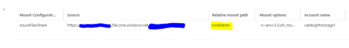

In my connected storage file share, I have folders ./data/inputs and ./data/outputs in the root of the storage file share. I have added the storage to the pool, and everything is reporting as successfully connected (I have created all roles, images etc).

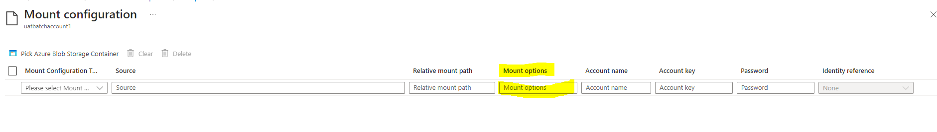

    2. Configure File Share Mounting:
      • Go to the "Configuration" section of your pool.
      • Under "Mount configuration," select "Add" to mount an Azure File Share.
      • Fill in the required details:
        • Storage account name: The name of your storage account.
        • File share name: The name of your Azure File Share.
        • Mount path: The path where the file share will be mounted on the compute nodes (e.g., '/mnt/data').
        • Account key: The key for accessing the storage account.

    2. the mounting options were left blank. I had to set up permissions dir_mode, file_mode etc.
