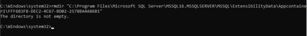

And indeed, folders are not removed. But they seem to be empty, so contents are probably removed, but folder remains and error entries are added. These error logs can grow huge. Multiple GB.
As for the permissions, I'm sure that both NT Service\MSSQLLaunchpad as well as SQL Server service account have full rights on that structure. Moreover, as part of testing, I even added these accounts to local administrators. That also did not solve the issue.
I would really appreciate any hints or suggestions on finding the root cause.

  1. RandomGuy123 45 Reputation points
    2024-07-25T15:45:12.04+00:00
    To add more details as I made some progress in my checks (Thanks to one of the checks that @Erland Sommarskog did on his machine finding out he is experiencing similar issue).
    All works when deleted from Windows Explorer.
    But it looks like it's an old problem in Windows that rmdir command (and probably used by Launchpad somewhere in the process) is causing problems ( I found some post from other people complaining on that behaviour).
    Even if executed as Admin on elevated CMD prompt:
    set zm="C:\Program Files\Microsoft SQL Server\MSSQL16.MSSQLSERVER\MSSQL\ExtensibilityData\Appcontainer1\22C73C41-4113-48C0-BA07-8646D49ECB0B\Documents"
    rmdir %zm%
    Access is denied.
    It's same error that is visible in Launchpad error logs.
    I did a test and If I modify the directory attributes and remove the read only and system, I'm able to remove the folder. Now it makes me wonder why these attributes are there in the first place and why Launchpad is failing on delete this.
    attrib -h -r -s %zm% /s /d
    rmdir %zm%
    It works, folder is removed.
    However this does not solve my problem as there are hundreds of folders automatically managed by SQL Launchpad
