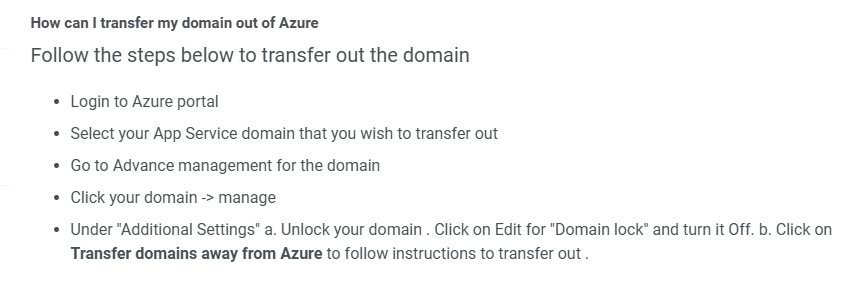

    Here is the reference that shows how you can transfer an app service domain out of Azure
    How can I transfer my domain out of Azure

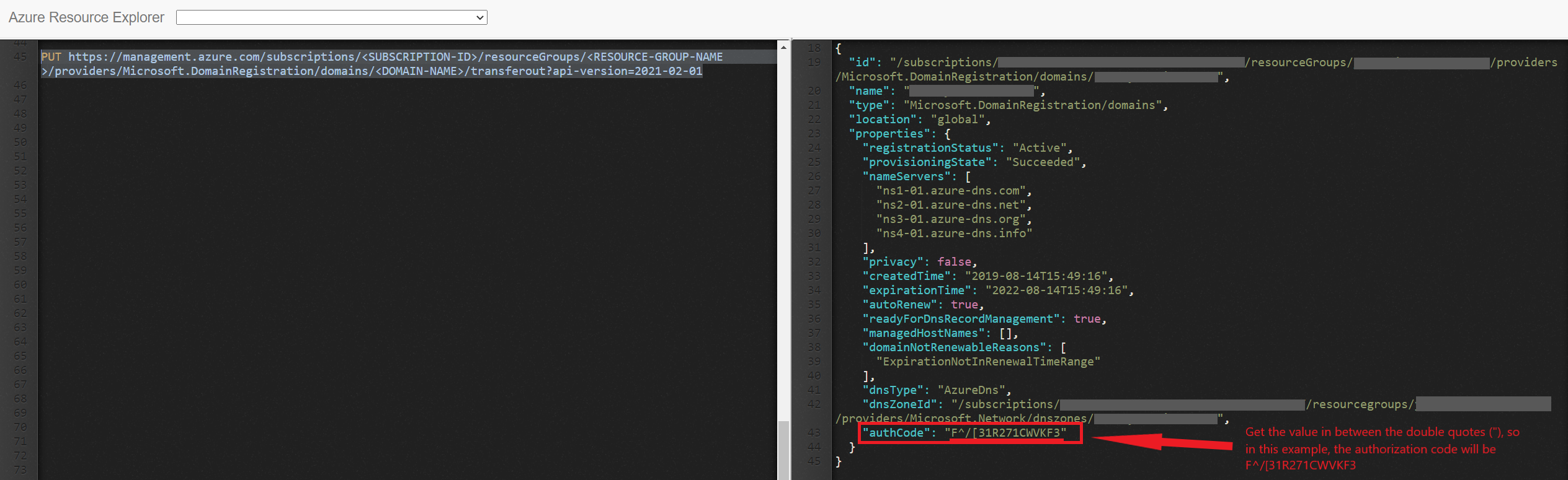

    Getting authorization code with transfer out API. You can use the transfer out API:
    PUT https://management.azure.com/subscriptions/<SUBSCRIPTION-ID>/resourceGroups/<RESOURCE-GROUP-NAME>/providers/Microsoft.DomainRegistration/domains/<DOMAIN-NAME>/transferout?api-version=2021-02-01
    You may be able to run this API on Azure Resource Explorer. Fill out the necessary information in between the “<” and “>” from the above, then paste the API call to you Azure Resource Explorer. Highlight the entire line from “PUT” until “api-version=2021-02-01” and hit Ctrl+S to run the command. You would expect similar results from the image below.
    Azure Resource Explorer Transfer Out
    Refer to the “authCode” value without the double quotes (“). This will be the authorization code you will need to provide the new domain registrar to transfer your domain out.
    Hope that helps. Please let us know if you have further questions.
