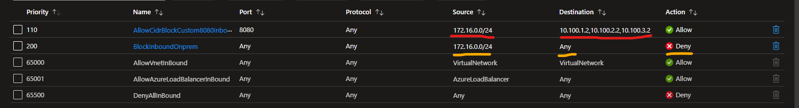

    I think the NSG rules should work in this scenario. From the 2nd post Site-to-Site VPN Subjects to NSG the NSG rules did not work because the customer there used Virtual Network Service tag which includes the on-prem private network as well. You can use the IP address spaces in the NSG to apply the required restrictions. As shown in the example below.
    Assuming your on-prem private network is 172.16.0.0/24 then you can set up inbound NSG rule as below
    Where Priority 110 allow the communication from on-prem( Source IP 172.16.0.0/24) if the destination IP address is 10.100.1.2, 10.100.2.2, 10.100.3.2
    Another Priority 200 deny the communication from On-prem ( Source IP 172.16.0.0/24) where destination is any IP address.
    As NSG Rules are processed in priority order, with lower numbers processed before higher numbers, because lower numbers have higher priority. Once traffic matches a rule, processing stops. As a result, any rules that exist with lower priorities (higher numbers) that have the same attributes as rules with higher priorities aren't processed.
    In the example above when rule with priority 110 allows communication rule with priority 200 is not processed and the request is allowed.
