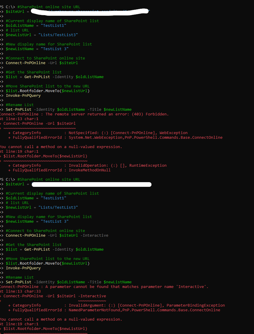

My goal is to udpate the sharepoint list using power automate. I can change the list name from out of the box Sharepoint, however it does not allow me to update the URL. I copied my code below and I am getting following error.
Error changing List URL! Exception calling "ExecuteQuery" with "0" argument(s): "The remote server returned an error: (403) Forbidden."
When I search for this error its user access error. however I am the admin and owner of the site. then I tried to execute following code without this lines of code and it works very well. that means may be can not move the list to the rootfoler?
#sharepoint online change library url powershell
    $List.Rootfolder.MoveTo($NewListURL)
    $Ctx.ExecuteQuery()
    #Keep the List name as is
    $List.Title=$ListName
    $List.Update()
    $Ctx.ExecuteQuery()
I am not sure please help me to solve this issue so I can able to update the List URL

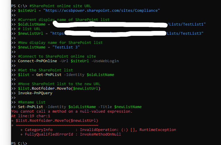

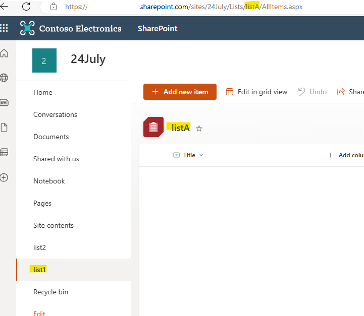

    I tested Patch fox's answer and successfully changed the URL and name of the List.
    I'm guessing your last null-value expression in a method problem is due to your $list being null, please double-check the URL and name of your current list before re-running the power shell.
    Attached below is my PowerShell and test results (in my case changed list1 to listA)

    Here is my result: User's image

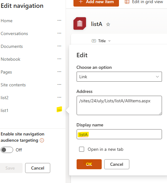

    You'll notice that the name on the side navigation bar hasn't changed, but you can click Edit below and rewrite the name on the quick navigation bar.
    Hope this information helps.

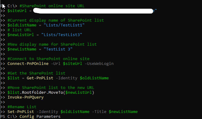

    Hi kem104, I want to help you to solve your problem.
    As I understand, you get a 403 error when you want to rename a SharePoint URL of a list item via Powershell, right?
    Firstly, why do you use the SDK and not the widely used PNP module of PowerShell?
    Is it possible to try it with the following example code:
    SharePoint online site URL
    $siteUrl = "https://contoso.sharepoint.com/sites/SPConnect"
    Current display name of SharePoint
    list $oldListName = "Images List"
    New list URL $newListUrl = "Lists/LogoUniverse"
    #New display name for SharePoint list
    $newListName = "Logo Universe"
    Connect to SharePoint online site
    Connect-PnPOnline -Url $siteUrl -Interactive
    Get the SharePoint list
    $list = Get-PnPList -Identity $oldListName
    Move SharePoint list to the new URL
    $list.Rootfolder.MoveTo($newListUrl)
    Invoke-PnPQuery
    Rename List Set-PnPList -Identity
    $oldListName -Title $newListName
    Source: https://ganeshsanapblogs.wordpress.com/2023/03/22/change-sharepoint-online-list-url-using-pnp-powershell/
    If you get the same error, we can check and troubleshoot again what's going on there and what could cause the problem.
