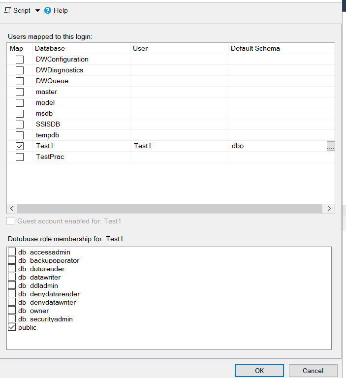

  2. Zahid Butt 966 Reputation points
    2024-07-26T13:31:15.6733333+00:00
    In this case customer needs to give 'membership in the public role' on requested database to that user.
    For further info please refer to:
    https://learn.microsoft.com/en-us/sql/t-sql/functions/has-dbaccess-transact-sql?view=sql-server-ver16
    In security->Users right click on target user->Properties->User Mapping-> check Target database & ok:
