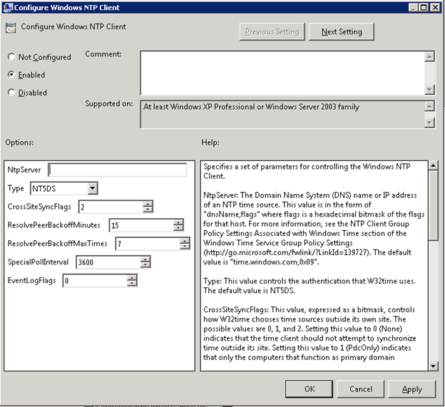

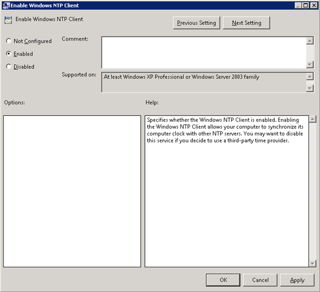

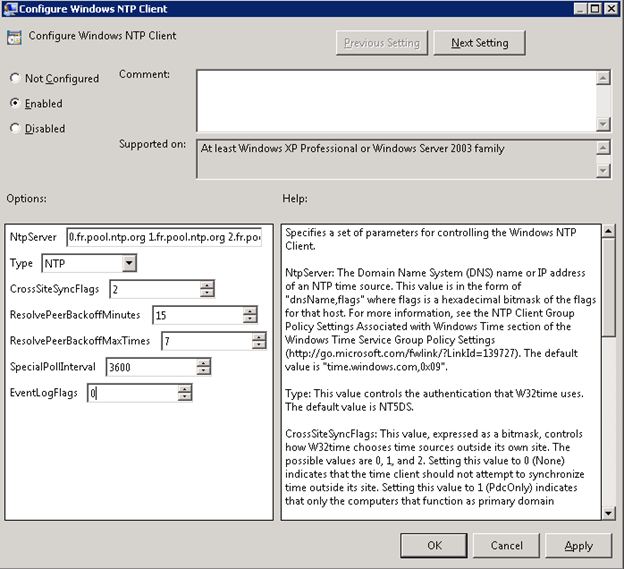

    The following are the GPO settings on PDC and other computers.
    ===PDC===
    Computer Configuration\Policies\Administration Templates\System\Windows Time Service\Time Providers\Enable Windows NTP Client should be enabled
    Computer Configuration\Policies\Administration Templates\System\Windows Time Service\Time Providers\Configure Windows NTP Client should be enabled with “NTP” as Type and the NTP server(s) to use set as NtpServer (You can add multiple NTP servers by separating them with a white space)
    ===Other domain controllers, member servers and Workstation===
    Computer Configuration\Policies\Administration Templates\System\Windows Time Service\Time Providers\Configure Windows NTP Client should be enabled with “NT5DS” as Type
