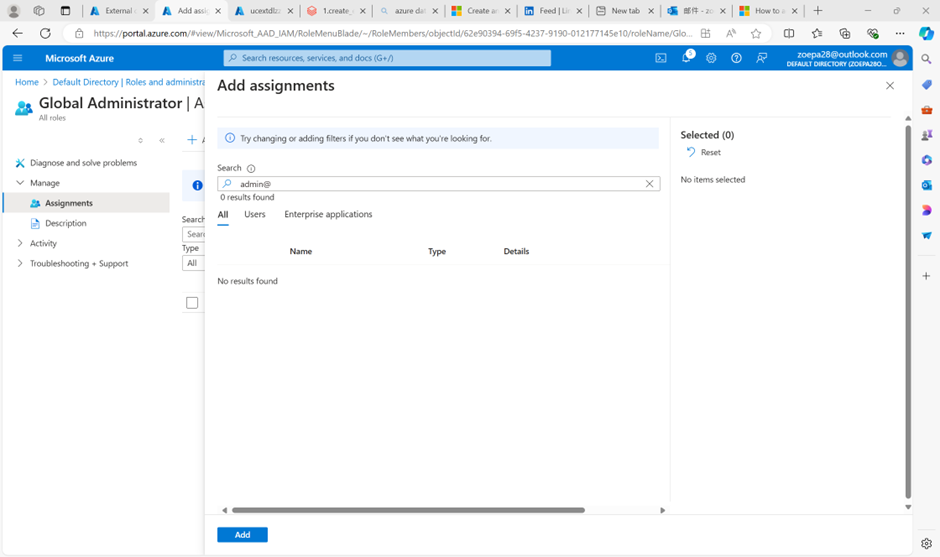

  2. Gunnvant Saini 0 Reputation points
    2025-02-17T11:16:26.2533333+00:00
    I am also facing the same issue. I am a global admin in my tennant:
    I am still getting the error while trying to access manage account in databricks. How to solve this
