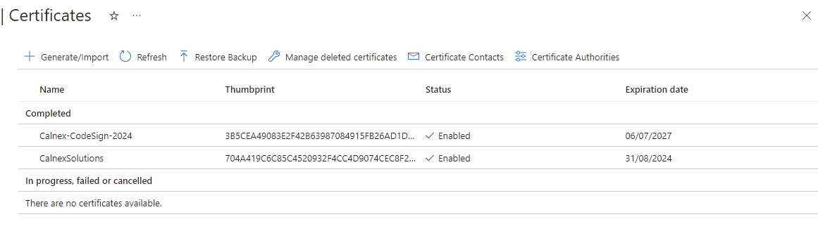

We have gone through the vetting and issuance procedure with GlobalSign and have successfully imported the new certificate into our Key Vault so we have our old EV signing certificate that expires shortly and our new certificate that is valid for the next 3 years.

Our old and new certificates have different subject names that include differences in email address (E) and state (S) properties but are identical apart from that (so they have the same CN attribute name as you can see above both certificates have the same title).
Could having the same CN attribute in both versions of the signing certificate be causing trust issues here?
