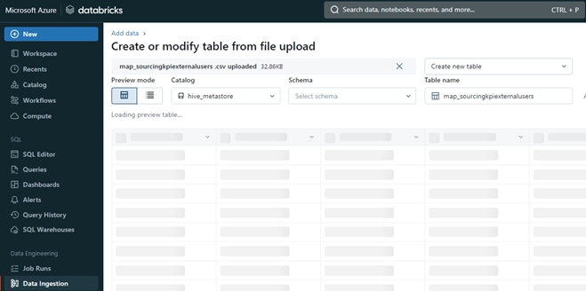

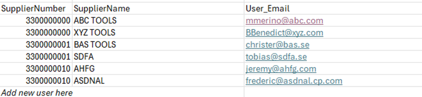

1.       Input
-            I have an Excel file named External_Suppliers_ADGroup2 that uploaded into the Databricks
-            Everytime I need to add a new user – I just insert new rows including Email of the user and SupplierNumber that the user should see
Upload the mapping file into Azure Databricks

·       So the purpose is I want only that user email can see that specific supplier
From the above example: ******@abc.com only see SupplierNumber 33000000

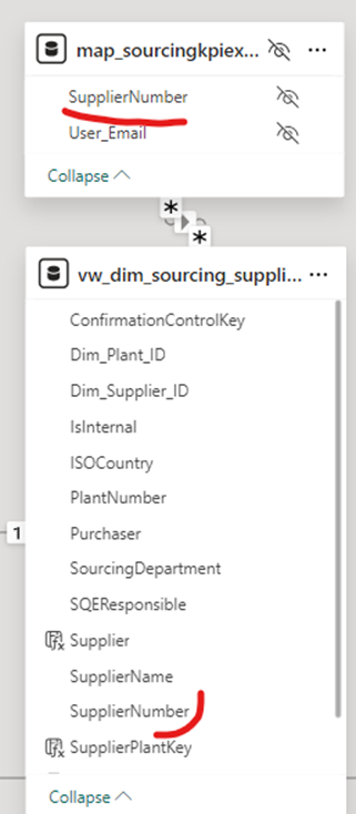

·       Below is my data model, mapping by SupplierNumber

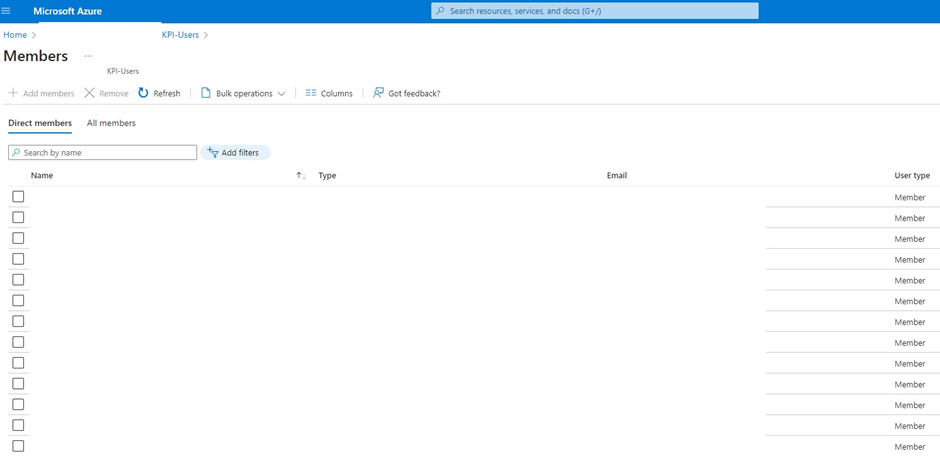

3.       Adding new users into the ADGroup2:
After doing the RLS code in Databrick, I would like to add these new users email into the ADGroup2. ADGroup2 are external suppliers, who can access the report at RLS level.

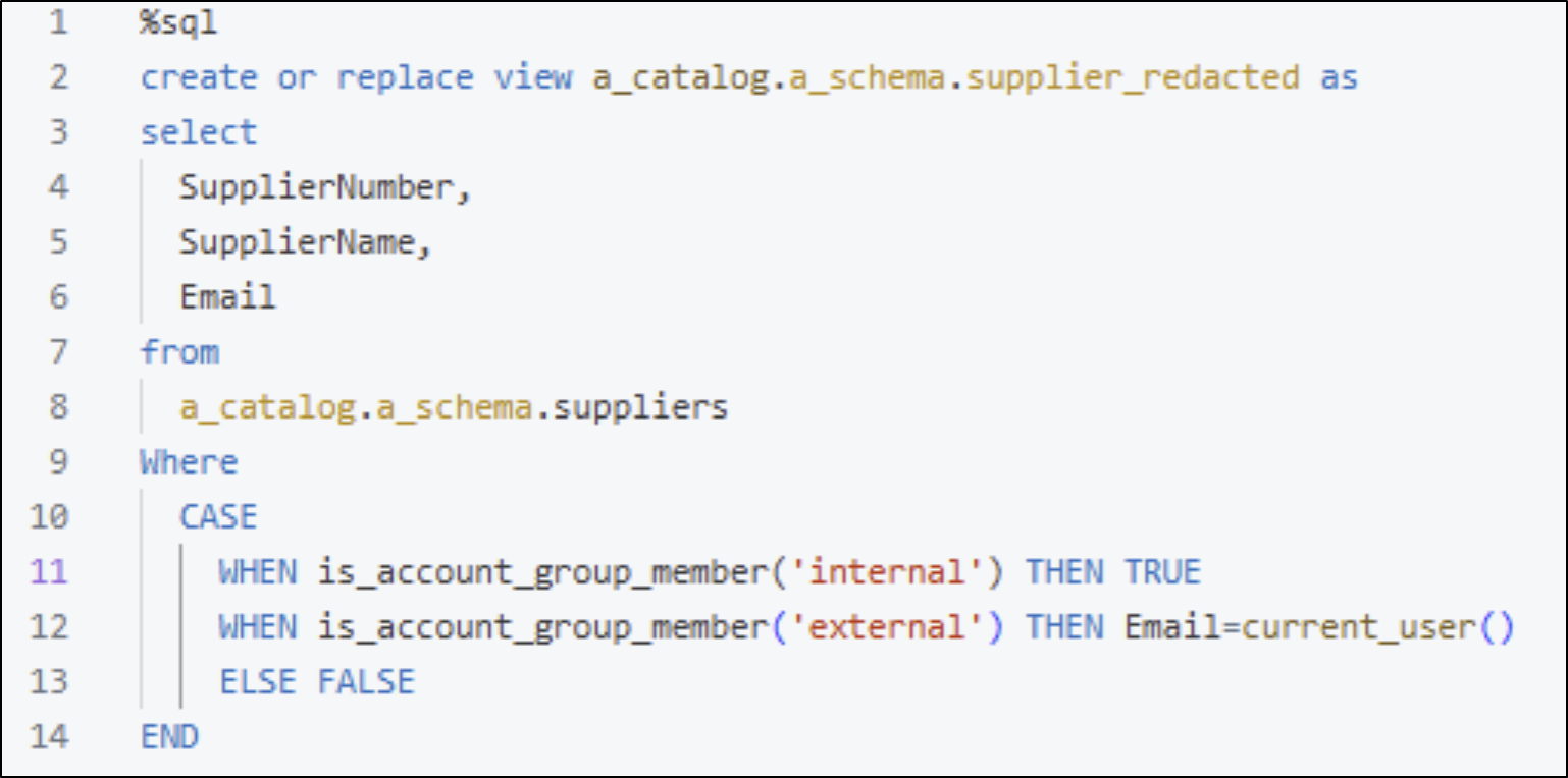

    For Q1, there can be many ways, one way is to create View and in SELECT of columns you can put this CASE and use the IS_MEMBER.
    See if the below code helps.
