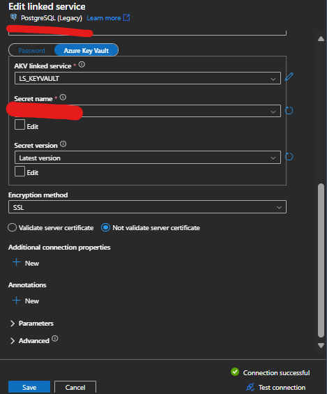

Currently I´m using the legacy LS for Postres SQL (SHIR) and the connection is working fine. I need to update the linked service (MS recomend to do it until 31/10/2024) but I´m receiving an error while testing the connection for the new one.
Here´s the LS legacy, using encryption method SSL and Not validate server certificate:
    "name": "PostgreSqlLegacy",
    "properties": {
        "annotations": [],
        "type": "PostgreSql",
        "typeProperties": {
            "connectionString": "Host=xxx.postgres.database.azure.com;Port=5432;Database=xxx;UID=xx;EncryptionMethod=1;ValidateServerCertificate=0",

  1. Amira Bedhiafi 33,071 Reputation points Volunteer Moderator
    2024-08-01T16:25:45.55+00:00
    I think you need to verify if your PostgreSQL SSL/TLS configuration matches what is expected by
    the linked service configuration because from the message I can see that you have handshake issues.
    Since you are using SHIR, verify that it has the necessary network connectivity and permissions to access your PostgreSQL server. Ensure that the SHIR is up-to-date and configured correctly to handle SSL connections.
    Can you try the following ?
