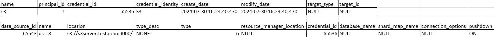

The existence of both s3 credential and ds_s3 external data source is confirmed by the query below.
SELECT * FROM sys.database_scoped_credentials SELECT * FROM sys.external_data_sources;
