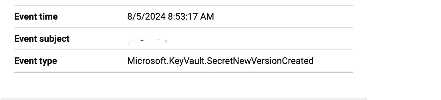

But i do not receive notification when the secret near be expired. And i hope the configuration is correct because when i add Microsoft.KeyVault.SecretNewVersionCreated in the Azure Event Grid config, i receive the notification for a new secret created in azure key vault.

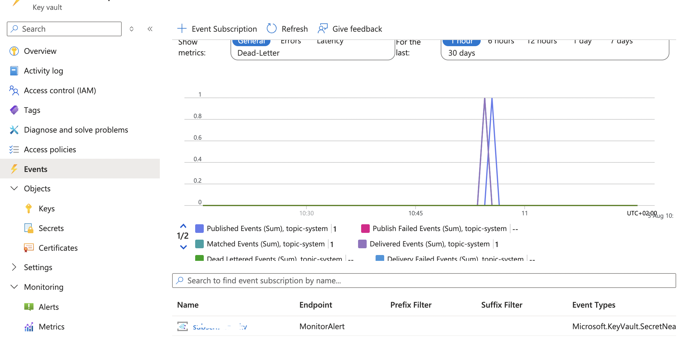

    If you are not receiving the alert, there are a few things I would check. First, go to the Key Vault and check the Events tab to confirm if the event itself fired.
