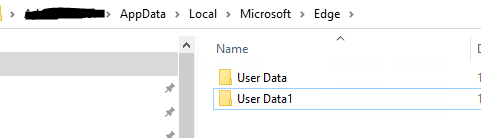

    1.Back up your User Data folder in the same path. Here for example, I back up the User Data folder as User Data1:
    2.Use User Data1 in your code to specify using Default profile when run Edge with Selenium:
    var options = new EdgeOptions();
    var service = EdgeDriverService.CreateDefaultService("C:\\Users\\XYZ\\ABC\\", "msedgedriver.exe");
    options.AddArgument("user-data-dir=C:\\Users\\XYZ\\AppData\\Local\\Microsoft\\Edge\\User Data1");
