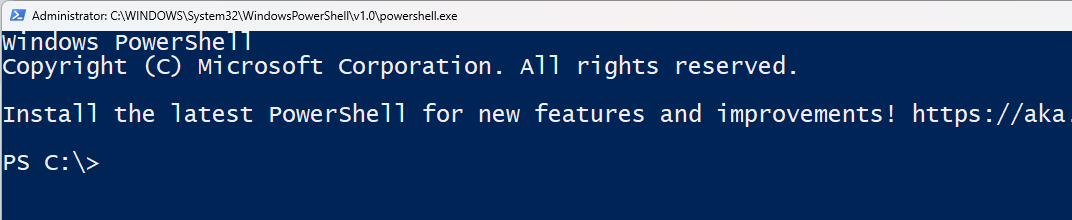

Hello,
We are seeing many different machines (Windows 10 and Windows 11) that are facing issues with Windows PowerShell
When someone tries to launch Windows PowerShell, the console opens to [Process exited with code 5 (0x00000005)]:
After further inspection of Event Viewer, many Engine Health errors occur wit "Settings: illegal characters in path"
Has anyone come across this issue before?
This is causing many downstream issues such as apps failing to install via intune.
This only happens with Powershell 5, PowerShell 7 works fine.
Kind Regards,
Dean

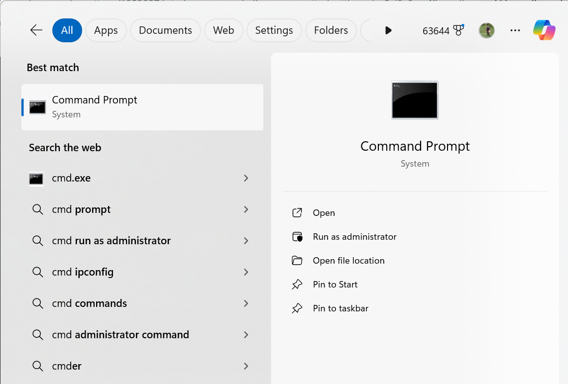

    Open Command Prompt as admin and run sfc /scannow and hit the Enter button.
    then: DISM /Online /Cleanup-Image /RestoreHealth and hit the Enter button.

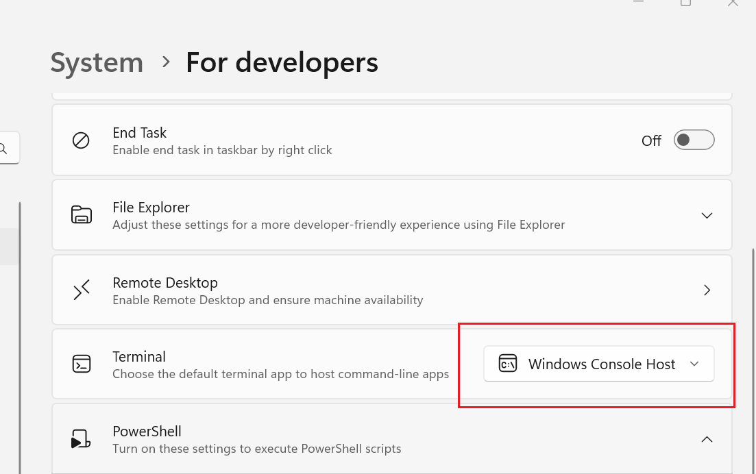

    That image looks like Terminal, and not Powershell. Did you change some setting to launch Terminal instead of Powershell.exe? Can you just run Powershell?

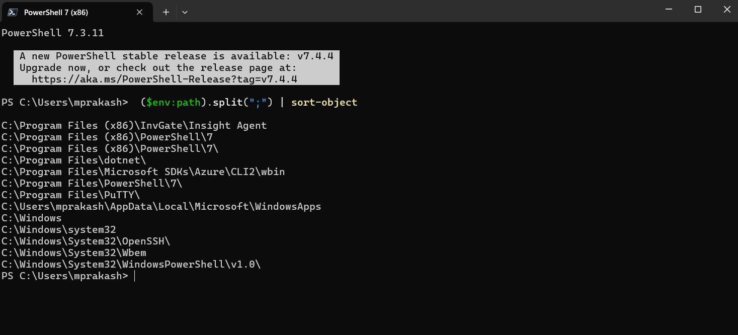

    Assuming that error is referring to the system path environment variable, run this statement in pwsh and look for non-ascii characters in folder names.
    ($env:path).split(";") | sort-object

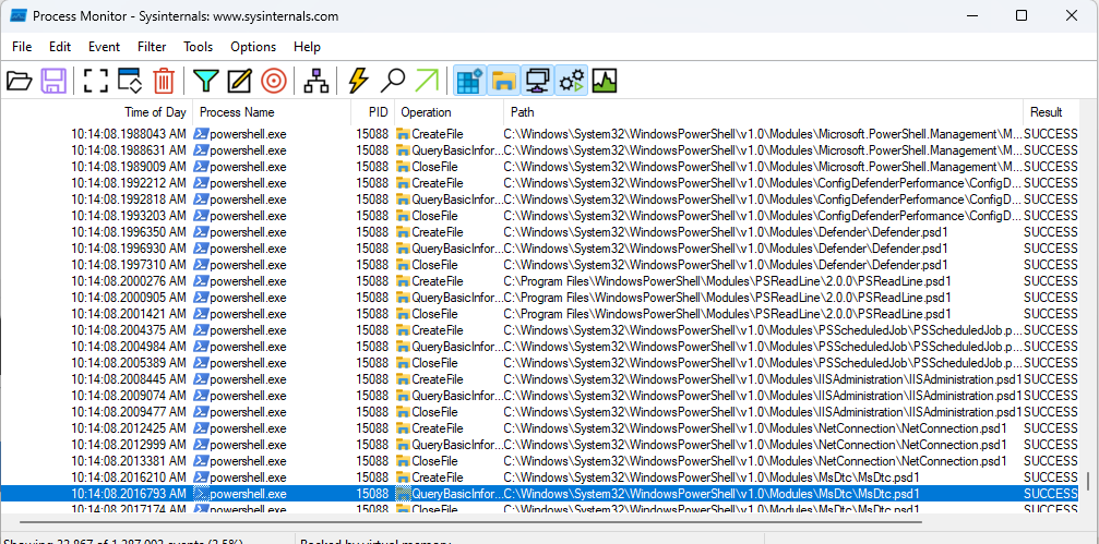

    If you don't find anything, run process monitor and trace it.
    https://learn.microsoft.com/en-us/sysinternals/downloads/procmon
    Add a filter to trace powershell and windowsterminal.
    Recreate the error and find where Terminal launches Powershell. Look at the command line that Powershell was launched with.
    Look at the files that Powershell tries to read and look for strange characters.
