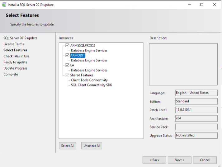

details first:

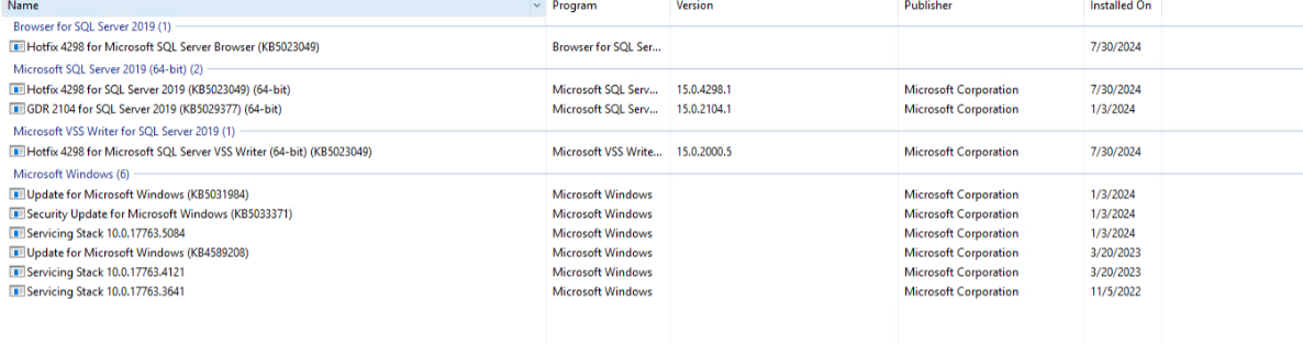

Installed updates:
1.installed updates
edit:

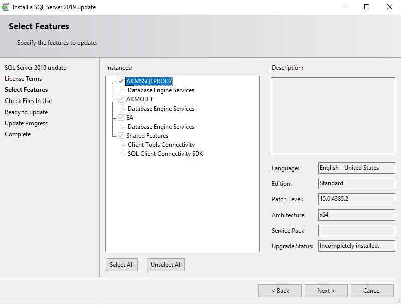

Problematic instance:
2
Others two have the same number.
3

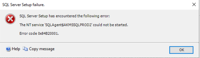

I'm trying to install SQL CU Update SQLsERVER2019-kb5039747-X64.EXE (also tried other version - same result).
After finish got error:

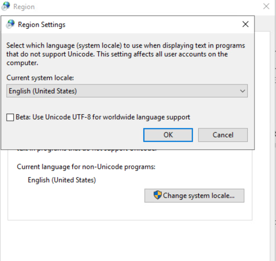

4
locale
Error.log attached: ERRORLOG.LOG
Also tried to uninstall this hotfix 4298 but after deinstall service didnt start
