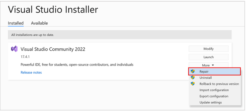

    You may install SQL Server Native Client for a try.
    If this does not work, please repair VS.
