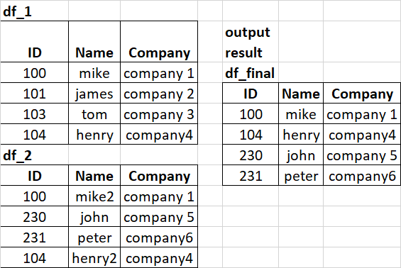

I have two dataframe in databrick notebook as df_1 and df_2
I want output from these two dataframe as df_final , shown in image below.
It should return matching row by (ID) from df_1 and only non matching row from df_2
Please let me know how I can achieve this in databrick using pyspark, should I use any join , filter or subtract ?

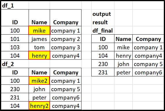

    Note: When you run the above code, you will see the error message:
    Because your data contains for ID 100 as mike and mike2 and 104 as henry and henry2.
    Reason: UNION can only be performed on inputs with the same number of columns, but the first input has 5 columns and the second input has 3 columns.
    Slight modification to the code would works as expected:
