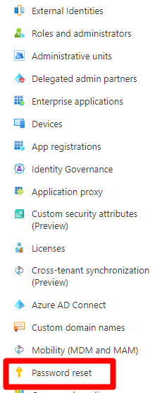

    I Solved this issue Llike this:
    i have the same scenario as you no "Security defaults" becasue we use CA as well.
    but I noticed we had an SSPR (Self Service Password Reset) policy and i had assigned a dynammic group to this policy, since this group is dynamic my break glass account was falling into this group, so i adjusted the parameters of the dynamic group so the break glass was no longer member of and guess wat i no longer get the Interrupt process to choose authentication method:
    i figured it all out after reading this:
