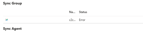

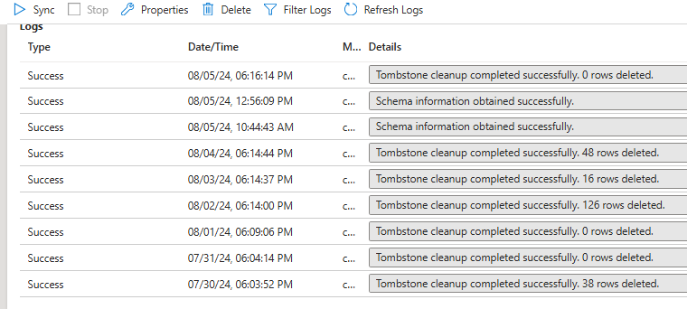

We have Azure SQL data sync which is working for last 6.5 years. But last week it suddenly stopped working we did not make any changes to Hub or member databases, neither change any SQL username or password, no updates to data sync, it was syncing the data till 27th July 2024 and suddenly stopped working on 28th July 2024. We get log messages as 'Tombstone cleanup completed successfully. xx rows deleted.' but no data is being synced between two databases, not showing any error message also. it's even not showing older logs like we would get the 'Load more' link button at the bottom to see old logs but now it's not showing this also.
for security purpose I have hidden the name.
The support team suggesting to recreate the sync group, but without knowing the root cause of the issue I don't feel I should recreate it, because it is production database and downstream systems depends on this. Kindly help
