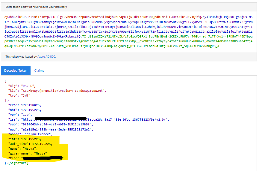

    To retrieve names in a B2C token, there is no necessity to utilize the Graph API endpoint at https://graph.microsoft.com/v1.0/me. Azure AD B2C allows the use of user flows and custom policies to facilitate identity user experiences.
    • User flows are predefined, built-in, configurable policies that we provide so you can create sign-up, sign-in, and policy editing experiences in minutes.
    • Custom policies enable you to create your own user journeys for complex identity experience scenarios that are not supported by user flows. Azure AD B2C uses custom policies to provide extensibility.
    Please follow below steps:
    1.Register a web application, create a client certificate, and ensure to grant administrative consent to the permissions. I believe the owner has already created the application in B2C. I would like to request that you cross-check the application against this document
    2.Create a sign-up and sign-in user flow and test flow you will get token along with claims.
    Please follow the steps outlined in this document.: Create user flows and custom policies in Azure Active Directory B2C
