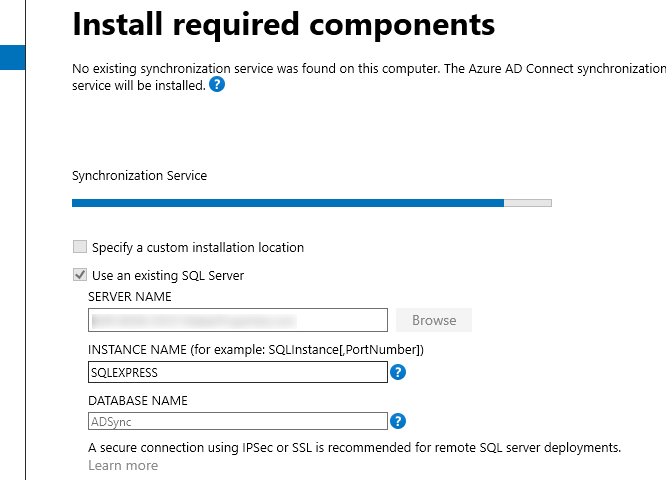

Unable to configure Entra ID Connect EventID 906 ADSyncBootstrap
David Sain 0 Reputation points
2024-08-08T16:40:39.1266667+00:00
Posted at https://answers.microsoft.com/en-us/windowserver/forum/server_devices-servertop_other/unable-to-configure-entra-id-connect-eventid-906/c703eaa1-419d-4849-bb2c-2fac44b96471
AAD Support at Pax8 won't help, says this is a server issue and to open a case with Microsoft Server support. I've tried 3 different version of AAD Sync install on Server 2019. They install fine but during the configuration, it halts at Synchronization Service.User's image
Event log shows
Event 906, ADSyncBootstrap
EnableADSyncBootstrapLocalDBInstance: Error while attempting to enable local db instance. Details: System.InvalidOperationException: LocalDB ShareInstance operation failed.
at Microsoft.Azure.ActiveDirectory.Synchronization.Framework.SqlLocalDbAdapter.ShareInstance(String instanceName, String sidOwner)
at Microsoft.Azure.ActiveDirectory.Synchronization.Framework.SqlLocalDbAdapter.CreateNewSQLLocalDBInstance(Version targetInstanceVersion, String targetInstanceName, String syncAdminsGroupUserName, String dbAdminUserAccount)
at Microsoft.Azure.ActiveDirectory.ADSyncBootstrap.ADSyncBootstrapManagementService.EnableADSyncBootstrapLocalDBInstance(Version targetInstanceVersion, String targetInstanceName, String syncAdminsGroupUserName, String dbAdminUserAccount)
MSSQLLocalDB\error.log shows success.
Trace log shows:

at System.ServiceProcess.ServiceController.get_Status()
at Microsoft.Online.Deployment.Framework.Providers.ServiceControllerProvider.StartService(String serviceName, TimeSpan timeout, Boolean verifyStart, String[] args)
[09:52:11.990] [ 36] [ERROR] ServiceControllerProvider: StartService unable to start service (ADSync). The system event log may contain more details for this issue.
[09:52:11.991] [ 36] [ERROR] PerformConfigurationPageViewModel: Caught exception while installing synchronization service.
Exception Data (Raw): System.Exception: Unable to install the Synchronization Service. LocalDB powershell operation failed on ADSync Bootstrap service: Enable-ADSyncBootstrapLocalDBInstance. Additional information may be found in the sql database error log files 'C:\Users\ADSyncMSA392b1$\AppData\Local\Microsoft\Microsoft SQL Server Local DB\Instances\MSSQLLocalDB\error.log'. Please see the Application and System event logs for additional details. ---> System.InvalidOperationException: LocalDB powershell operation failed on ADSync Bootstrap service: Enable-ADSyncBootstrapLocalDBInstance. Additional information may be found in the sql database error log files 'C:\Users\ADSyncMSA392b1$\AppData\Local\Microsoft\Microsoft SQL Server Local DB\Instances\MSSQLLocalDB\error.log'.
at Microsoft.Azure.ActiveDirectory.Synchronization.Setup.SynchronizationServiceSetupTask.InstallCore(String logFilePath, String logFileSuffix)
at Microsoft.Azure.ActiveDirectory.Synchronization.Framework.ActionExecutor.ExecuteWithSetupResultsStatus(SetupAction action, String description, String logFileName, String logFileSuffix)
at Microsoft.Azure.ActiveDirectory.Synchronization.Setup.SetupBase.Install()
--- End of inner exception stack trace ---
at Microsoft.Azure.ActiveDirectory.Synchronization.Setup.SetupBase.ThrowSetupTaskFailureException(String exceptionFormatString, String taskName, Exception innerException)
at Microsoft.Online.Deployment.OneADWizard.Runtime.Stages.InstallSyncEngineStage.ExecuteInstallCore(ISyncEngineInstallContext syncEngineInstallContext, ProgressChangedEventHandler progressChangesEventHandler)
at Microsoft.Online.Deployment.OneADWizard.Runtime.Stages.InstallSyncEngineStage.ExecuteInstall(ISyncEngineInstallContext syncEngineInstallContext, ProgressChangedEventHandler progressChangesEventHandler)
at Microsoft.Online.Deployment.OneADWizard.UI.WizardPages.PerformConfigurationPageViewModel.ExecuteSyncEngineInstallCore(AADConnectResult& result)
Server is fully updated and restarted. TLS 1.2 is explicitly enabled.
Have completely uninstalled, restarted, reinstalled each time, same error.
Installed MS SQL Express 2022 just because.
Reviewed the following:
https://learn.microsoft.com/en-us/answers/questions/1334042/error-when-trying-to-install-azure-active-director?cid=kerryherger
https://learn.microsoft.com/en-us/answers/questions/1374127/cant-install-microsoft-azure-active-directory-conn
https://community.spiceworks.com/t/adconnect-fails-to-install/828016
https://community.spiceworks.com/t/azure-ad-connect-failing-to-install/782353
https://www.reddit.com/r/MSFTAzureSupport/comments/1dlrace/microsoft_azure_ad_connect_entra_connect_setup/
Have ADSync installed on another server but is having errors and it was suggested that it be removed/re-installed. So was going to install in this server then remove from the old one. Maybe I should just roll the dice on the other partially working server and hope it doesn't tank.
