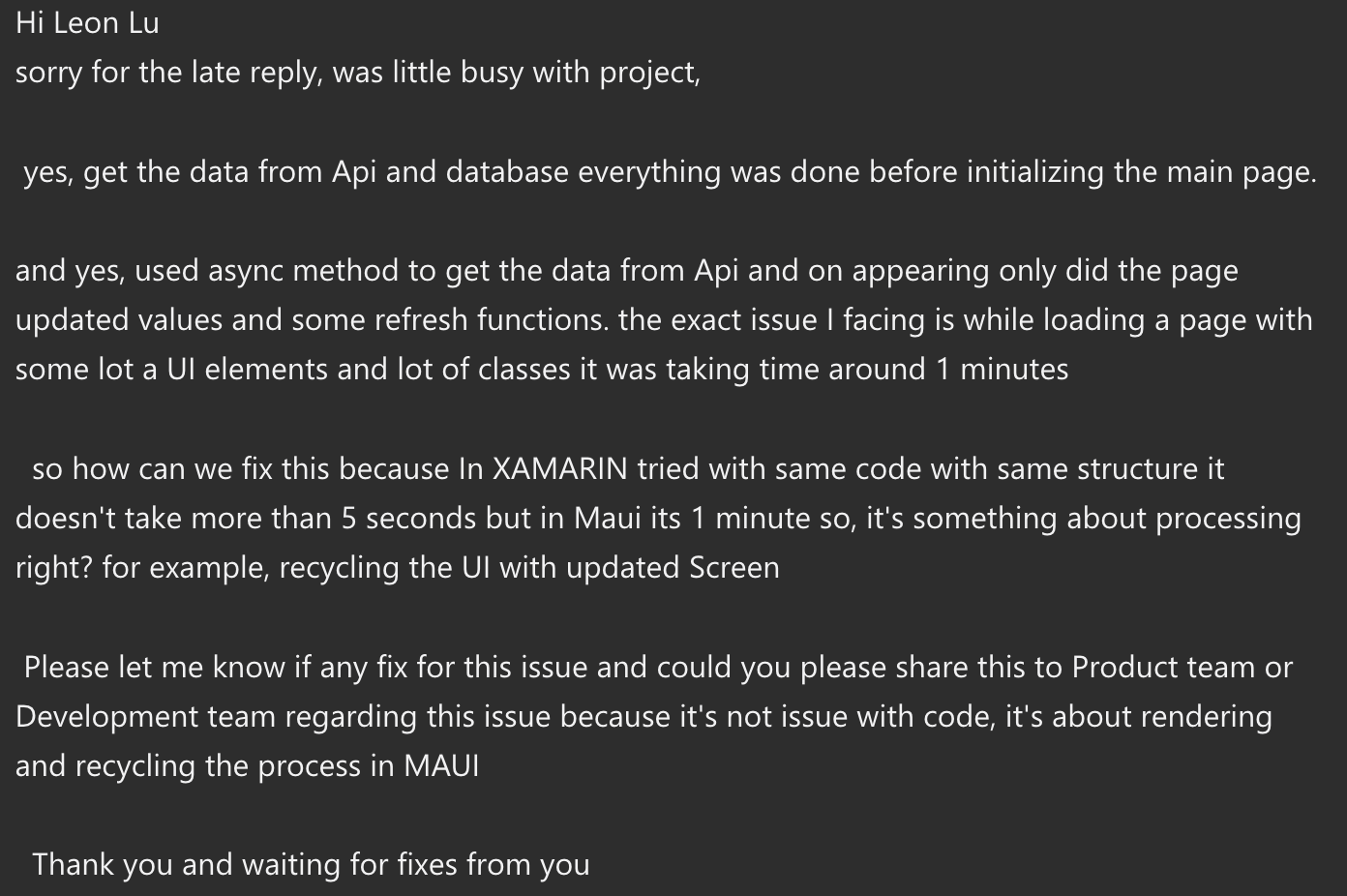

In Maui, when we set MainPage using Application.Current.MainPage right? there while I set my custompage as MainPage its take around 15 to 30 seconds to initialize page in UI part, apart from the loading custompage
code for example:
Application.Current.MainPage = new mycustompage() // here its take around 15 to 30 seconds to render and loading in the UI..
and i tried with this too after initialize page and set as mainpage still have issue -->
CustomPage page = new CustomPage();
Application.Current.MainPage = page; // still have performance issue
It would be more helpful if this issue have any fix, Thanks in Advance

  2. Muhesh Kumar Nagarajan 0 Reputation points
    2025-03-06T12:32:43.5533333+00:00
    Found the issue and fixed, Thank you everyone who helped me for this issue the root cause is when already initailized any observablecollection when reload page with rendered in xaml with some more collections inside the template its take some time to render for each item, thats why it was taken a lot of time after do changes to the observablecollection...if we dont have any change in list and again reinitialize it will not take so much time but after do update/add/delete it will take time to render xaml the fix for this when reinitialize for whole page with the observable collection just remove binding of the observablecollection and after that it will loads fast, but if going to use same page dont remove binding, only if reload page with same observable collection which already rendered the xaml with that collection only have this fix Thank you all
