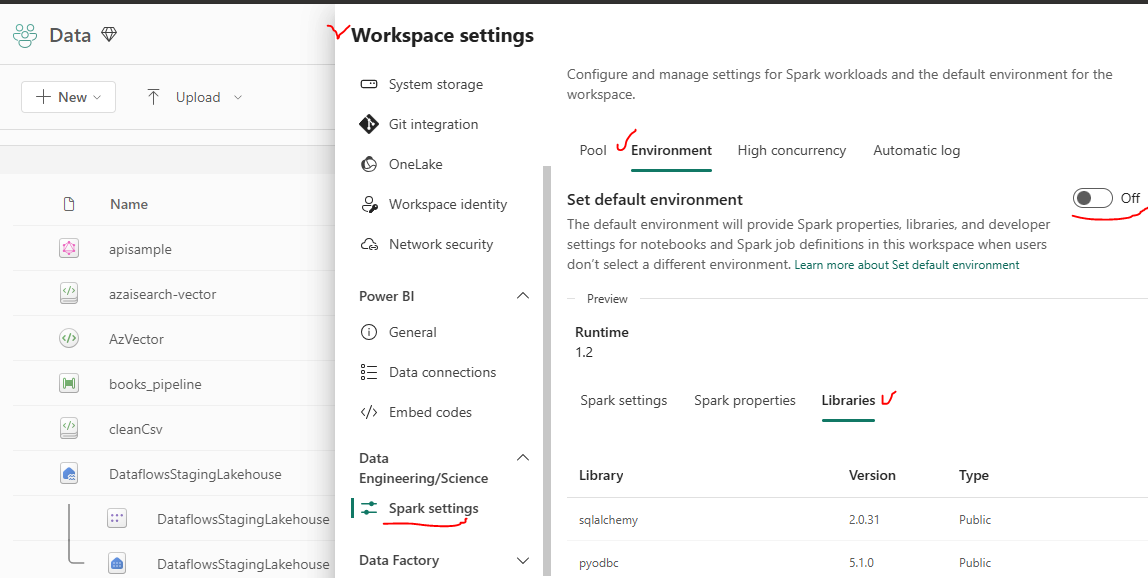

  3. Konstantinos Passadis 19,586 Reputation points MVP
    2024-08-12T20:42:30.8733333+00:00
    Hello @VR

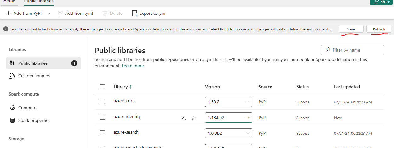

    I suggest to srt thr Default Environment :
    ALSO :
    Find the Environment in the Workspace and if the library is not there yu can add it , but if it i part of another package no need to do that . Just remember to SAVE and PUBLISH , it takes some time !
    I hope this helps!
    Kindly mark the answer as Accepted and Upvote in case it helped!
    Regards

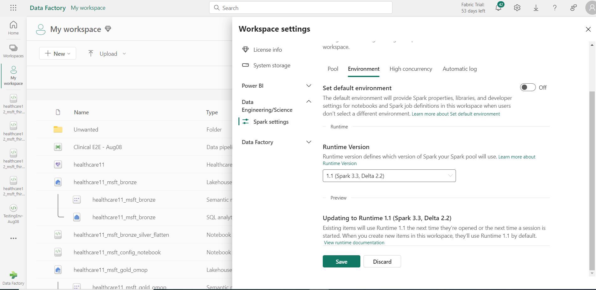

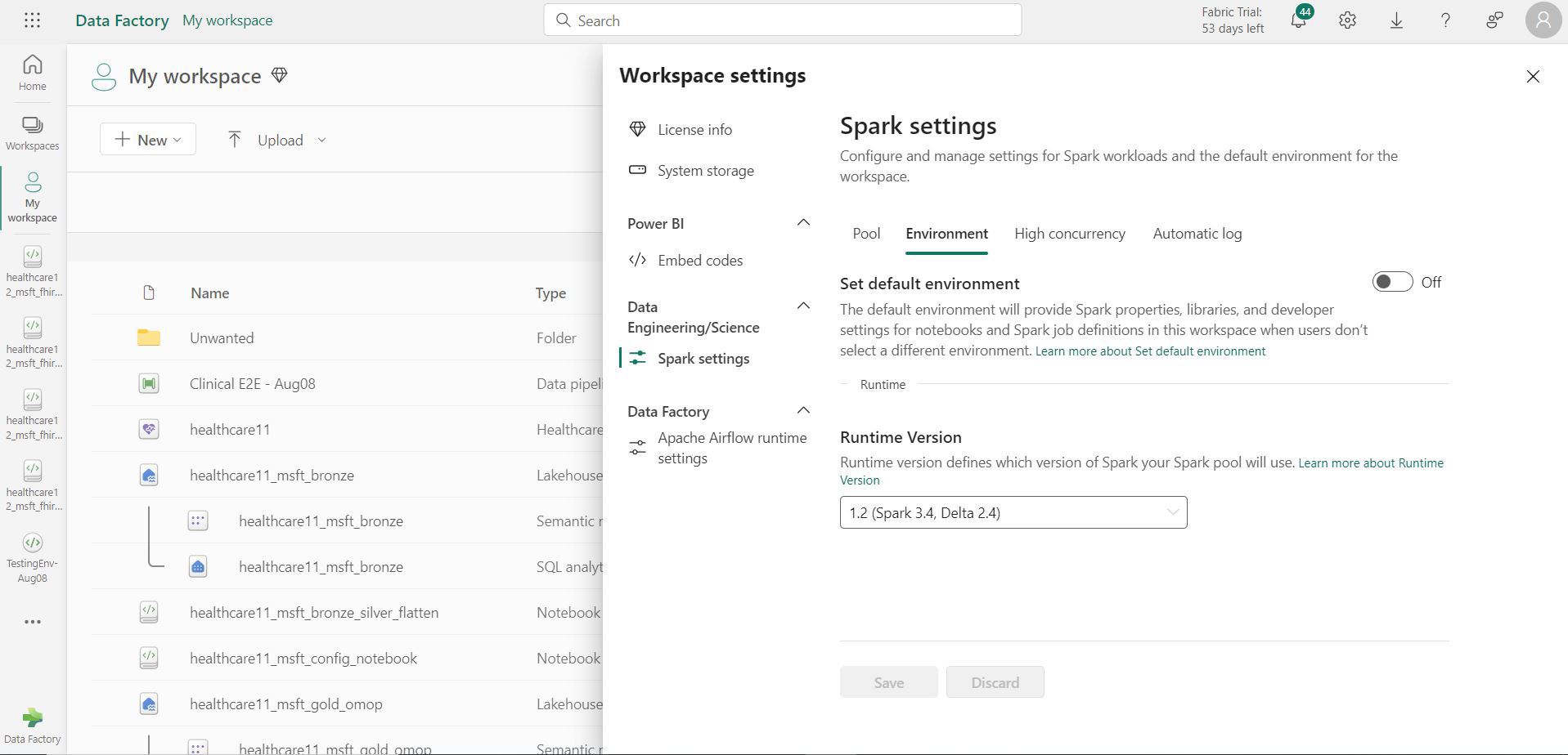

  4. VR 0 Reputation points
    2024-08-13T00:05:30.12+00:00
    Thanks. I had the runtime version set as 1.1 before. I did not see the option for libraries. So i changed it to 1.2. I still do not see the "Libraries" option in the Workspace settings as you do:
    Dflt Env 1.1
    Dflt Env 1.2
    Not sure what I am missing :(

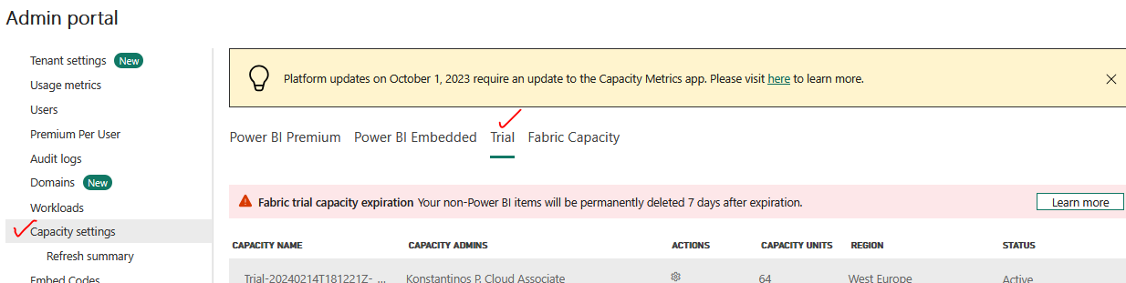

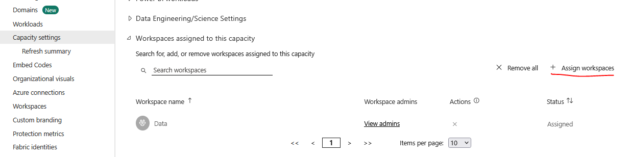

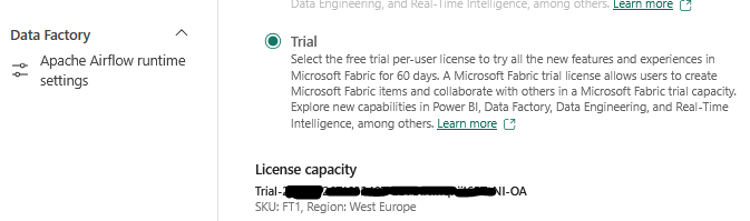

  5. Konstantinos Passadis 19,586 Reputation points MVP
    2024-08-13T13:53:59.0566667+00:00
    Hello @VR !
    have you activated the correct License Model ?
    https://learn.microsoft.com/en-us/fabric/data-engineering/create-and-use-environment
    It explains everything about Environments how to !
    Also try from the Admin Portal and see if any setting there is relevant and disabled
    For example the ability to assign access to Workspaces
    Finally make sure the Capacity Trial is used and assign the Workspace to the Capacity Trial:
