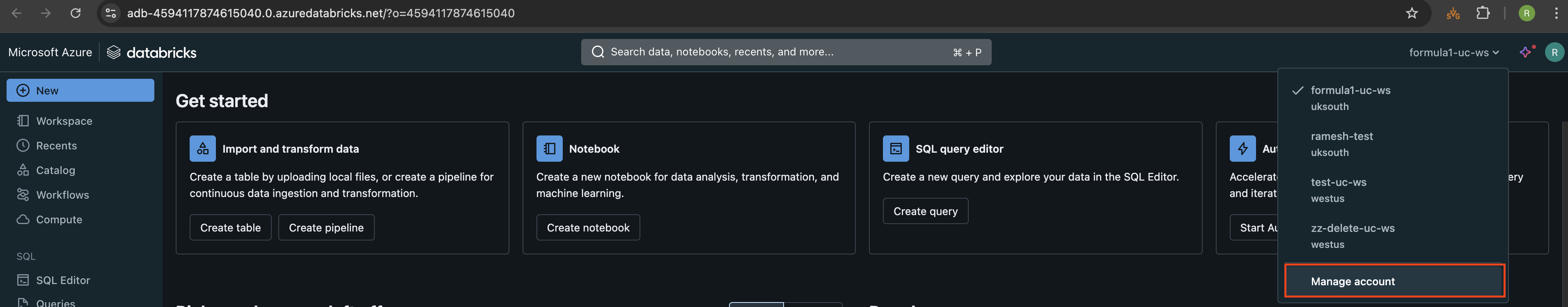

I have a personal Azure pay-as-you-go subscription in which I have the 'Global Administrator' role. I am also the databricks account administrator.
Until two weeks ago, I was able to access the databricks account console without any issues, but I am facing issues during the last 2 weeks as below. It's not only isolated to me. I have checked with other users in my user group and they are facing the same issue. All of them were able to access the account console in the past.

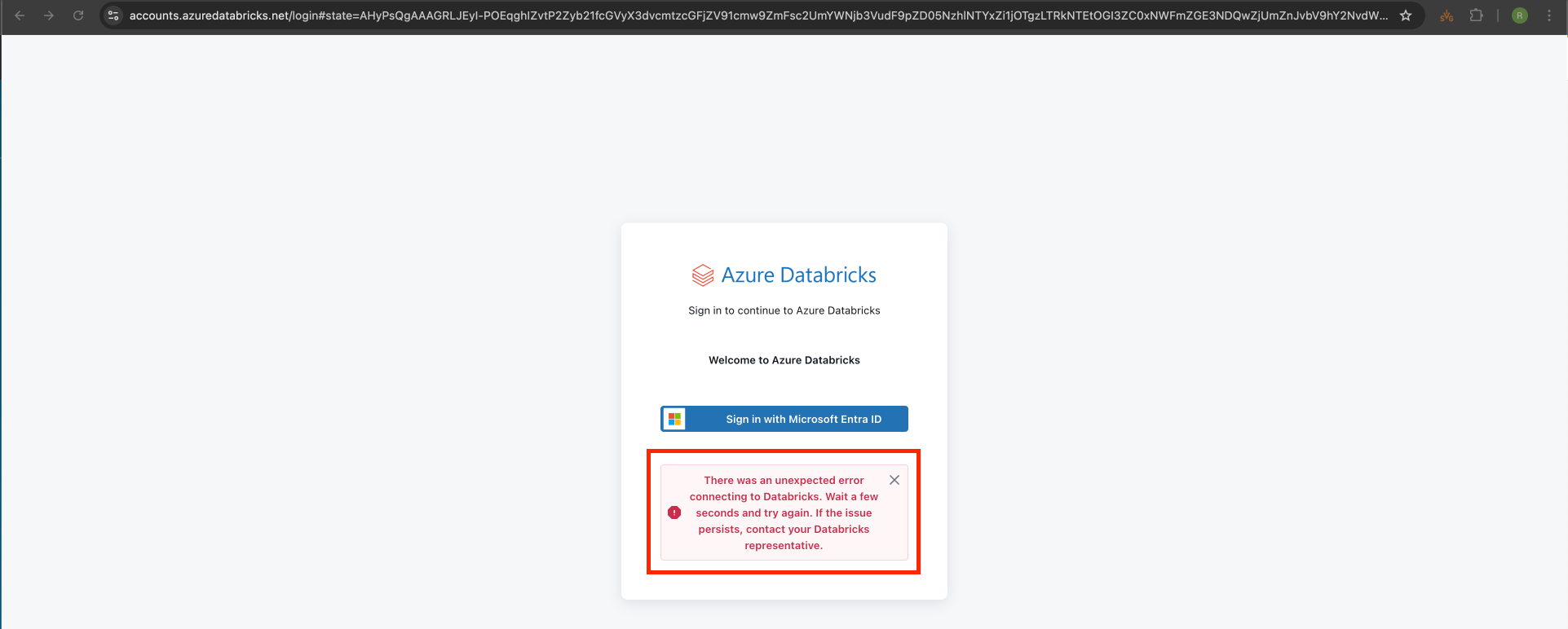

I am accessing the account console via the 'manage account' menu as below
Screenshot 2024-08-07 at 12.13.53
This takes us to the page below with the error as shown here
Screenshot 2024-08-07 at 12.15.30
It suggests the error is temporary, but I have been seeing it over the last 2 weeks.

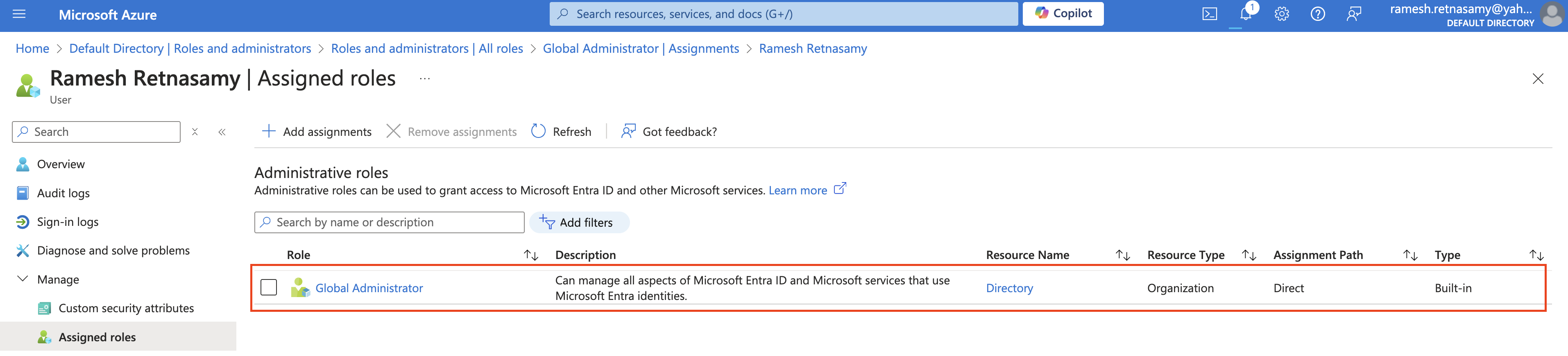

As you can see below, the user I am trying to access has Global Administrator role.
Screenshot 2024-08-07 at 12.17.20

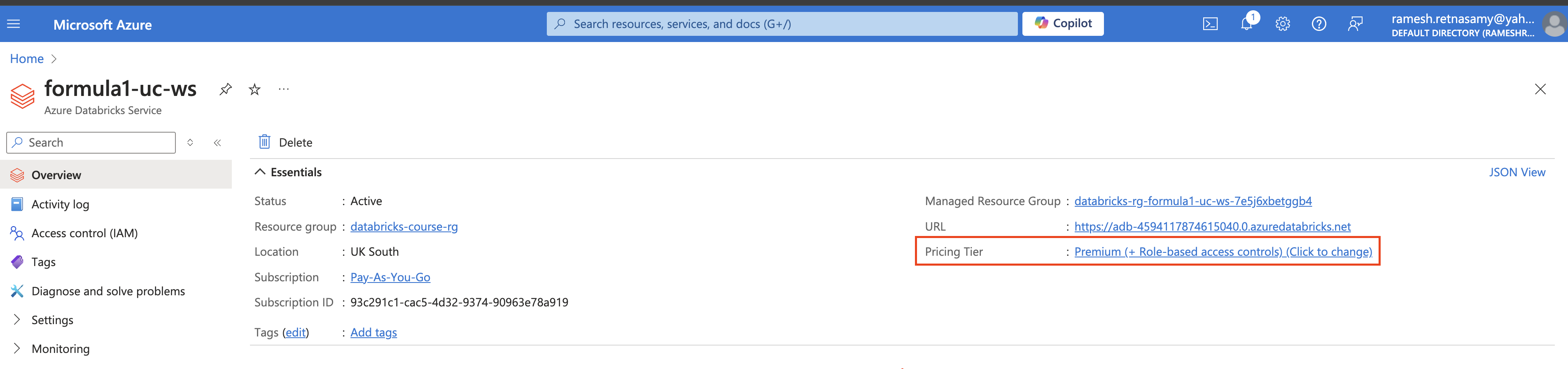

Also, the workspace is a premium workspace as below
Screenshot 2024-08-07 at 12.18.35
