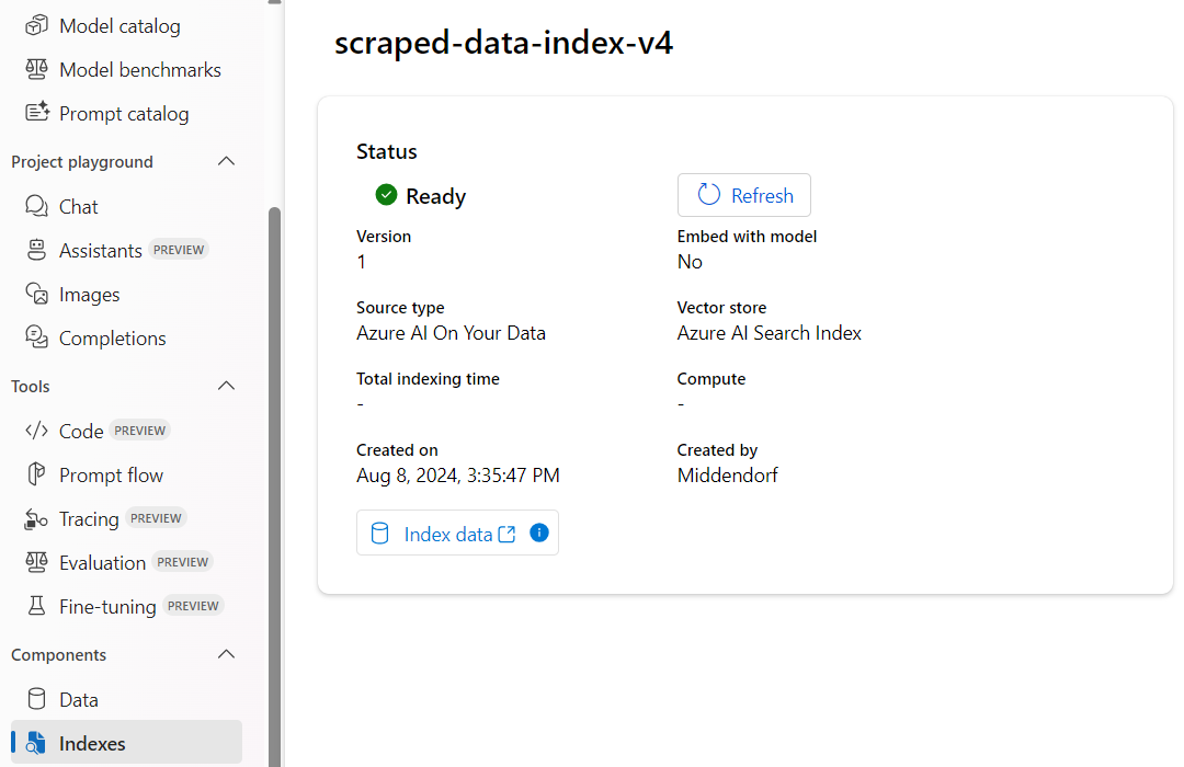

I have this vector index that is being used by my prompt flow AI chatbot and i forgot to give it a file while creating it or want to add more.
I see that vector indexes have versions but i see no button or way to create a new version.
The data used by the index also has versions and does have a button or way to "update" it.
Issue is it seems this undoes all the jobs (chunking etc) that were executed at the initial creation of the vector index.
How can I update or add to the data my vector index uses so that my chatbot can access additional information without having to recreate it every time from scratch and change the reference.

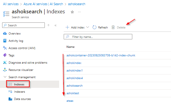

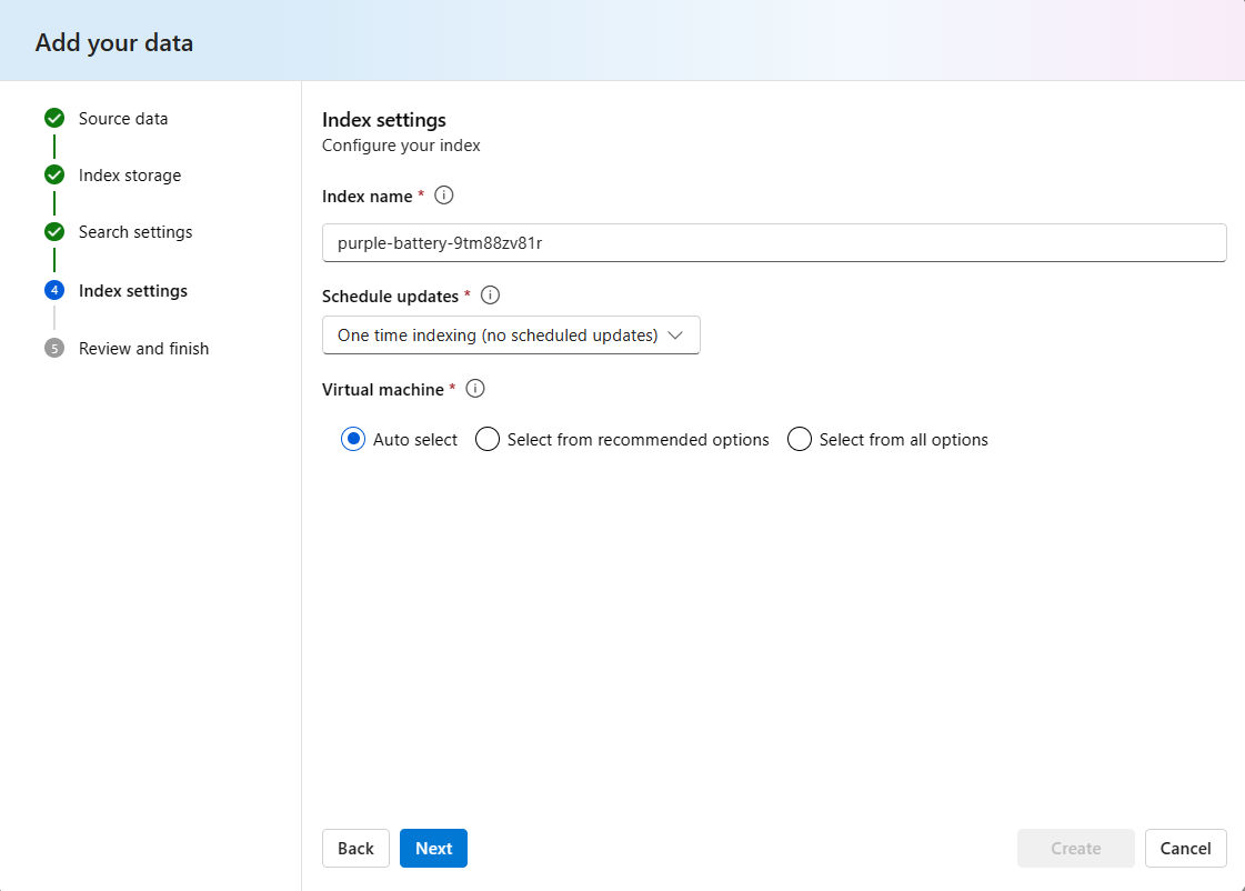

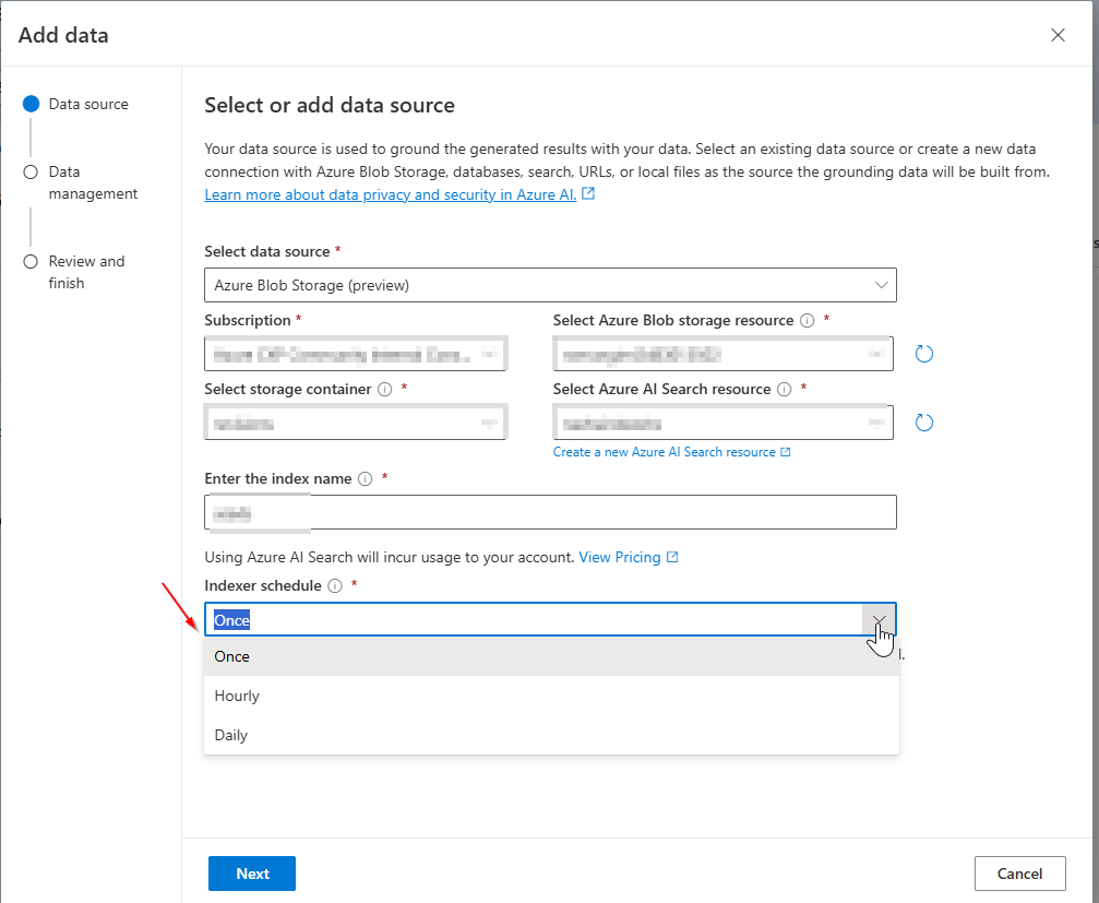

    Did you check this build and consume vector indexes in Azure AI Studio already? You can schedule updates. Also, you can choose to update the index hourly or daily.
    Once the Indexer is established, you can also directly modify the schedule settings through the Azure AI Search Portal. See Update or rebuild an index in Azure AI Search and Schedule automatic index refreshes for more details.
