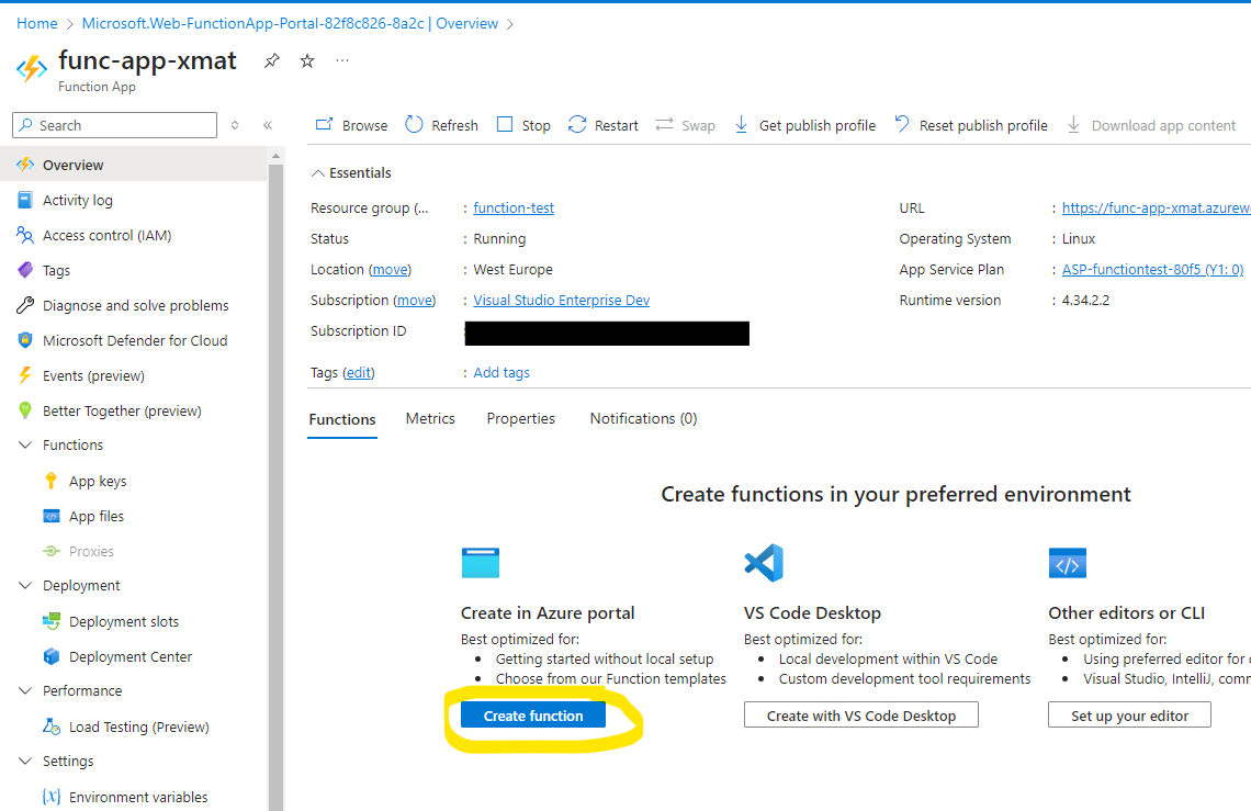

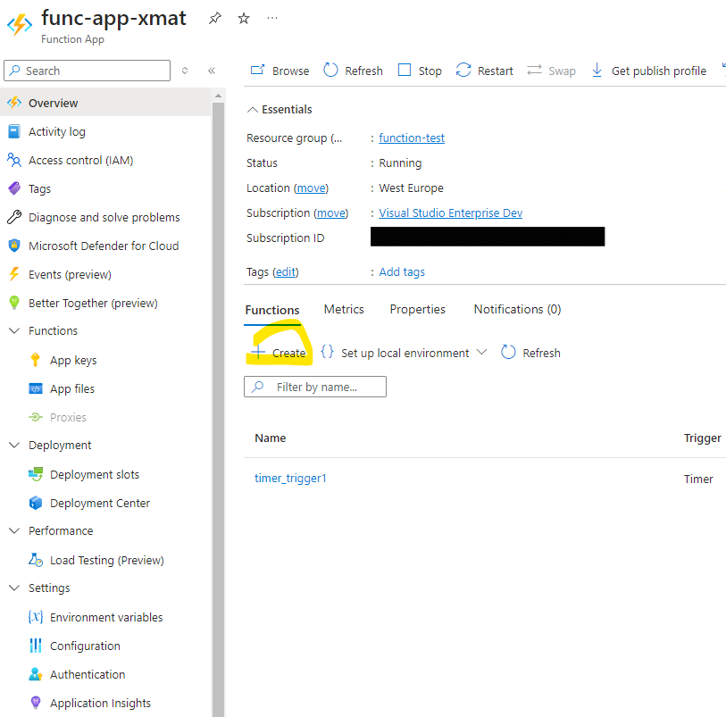

    1. Go to your newly created function app and on the 'Overview' page in the middle you can find 'Functions' tab and press 'Create function' under Create in Azure portal. This option is only available for functions with no functions deployed yet.User's image When you already have any function you have to press '+ Create' and follow below steps.User's image

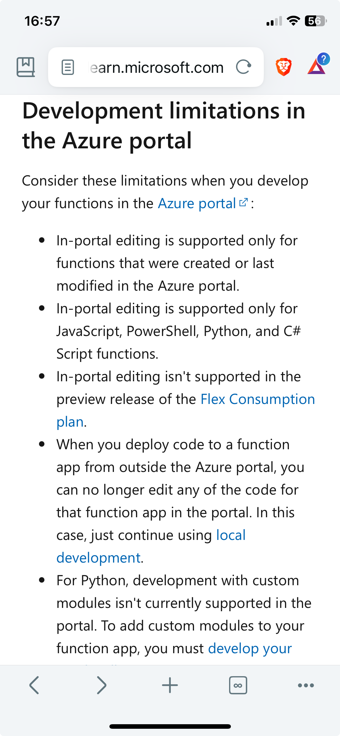

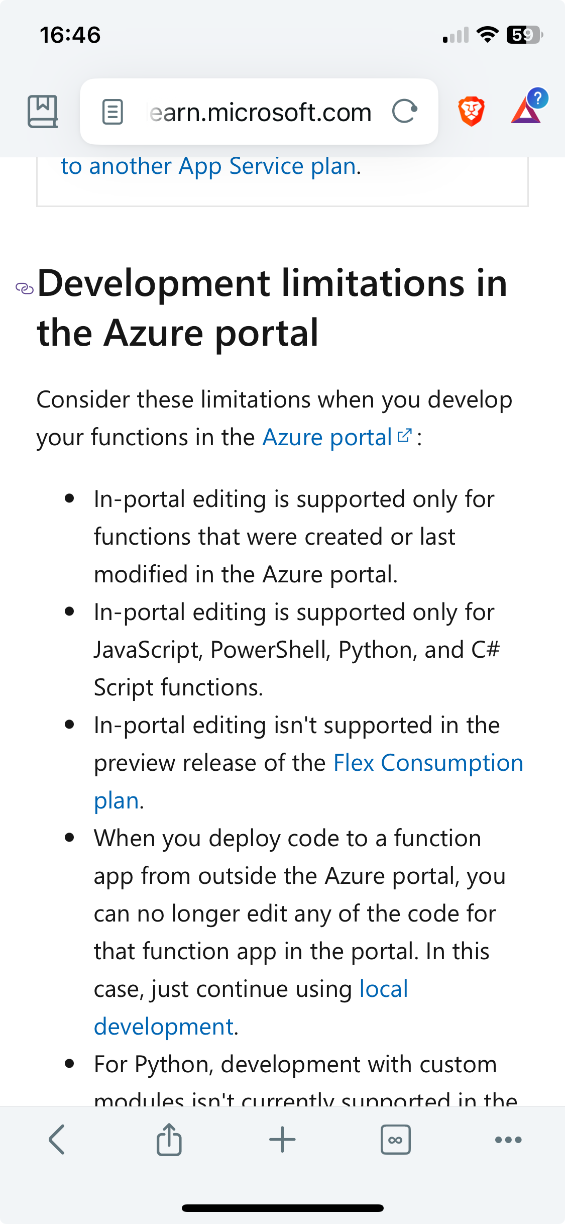

    Interesting is that when your functions are managed outside the portal via. VS code or Github repo, this option dissapear and you cannot create any functions from Portal..

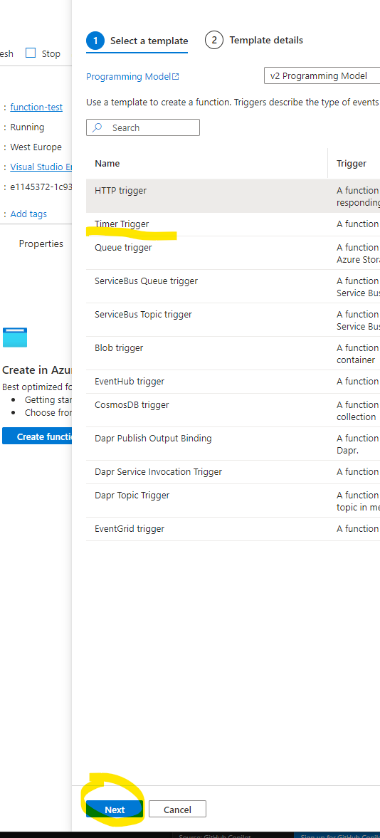

    1. Select 'Time Trigger' and press next User's image
    2. in Template details tab, update 'Schedule' text box with new value from tutorial. ' */20 * * * * * User's image I hope this help you continue your Azure learning Jurney! ;) Please accept this answer if helpul.

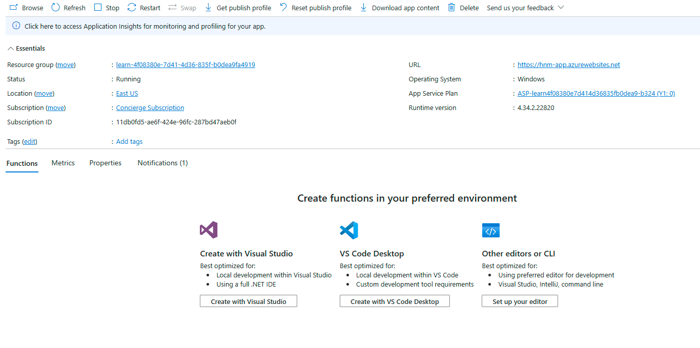

    I am not getting the option to "Create in Azure Portal". I tried with .NET 6 and .NET 8 runtime. I am using Edge browser. Is it a bowser specific issue?
    Not sure if this is a bug or a latest update where it is replaced with "Create with Visual Studio" or maybe I don't have privilege to "Create in Azure Portal" in Sandboxing environment.
