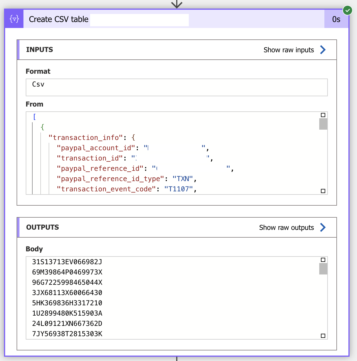

With Azure logic apps, I am taking json as an input and generating a csv output from it. There is a requirement for me to remove all the line breaks from my csv output if it looks like this:
A
B
C
D
I expect the final response to be stored in a variable as A,B,C,D. Below are all possible options I've tried, but none of them work -
Screenshot 2024-08-15 at 10.01.27
Approach 1: Created a new singleReturn variable
replace(body('Create_CSV_table'),variables('var_newLine'),',')
Approach 2:
replace(body('Create_CSV_table'),decodeUriComponent('%0A'),',')

    Your plan of attack seems correct, however I do believe that the place where you're replacing the text is where it is going wrong. I think you should already remove the new line feed in the JSON, and push that to the CSV as input, kinda like this:
    json(replace(string(body('YOUR_JSON_ACTION')),variables('``var_newLine``'),','))
