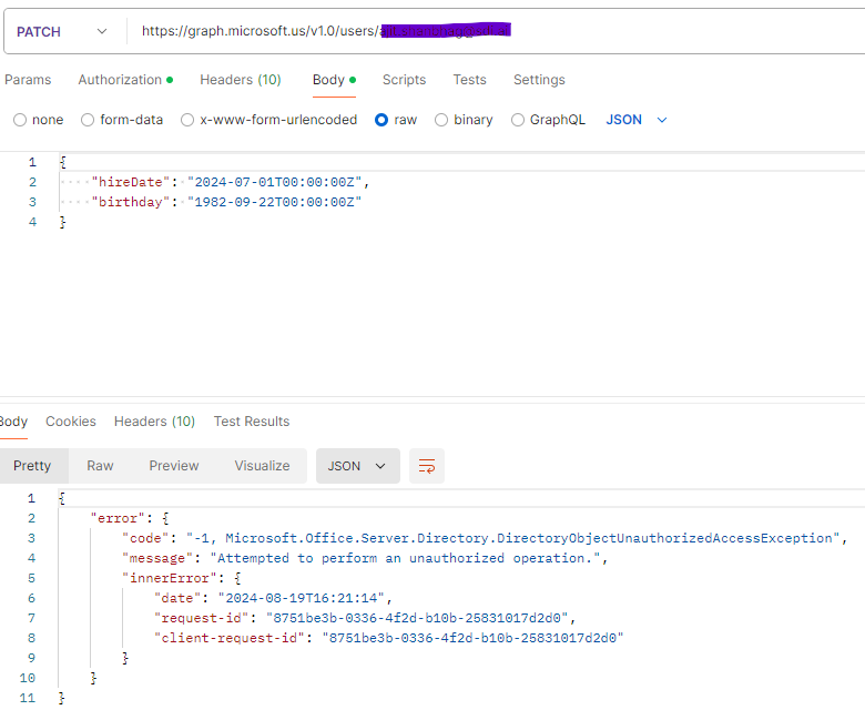

I am using MS Graph API to update the hire and birth date. Below are the details:
PATCH API - https://graph.microsoft.us/v1.0/users/{user-identifier}
Payload for hire and birthday -
    "hireDate": "2024-07-01T00:00:00Z",
    "birthday": "1982-09-22T00:00:00Z"

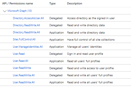

API Permission in the app registered in Azure portal -
The update has been working fine since it was developed 4 months ago. Starting Aug 8, 2024, the API is failing to update the hire and birth dates. Kindly assist in providing the solution.

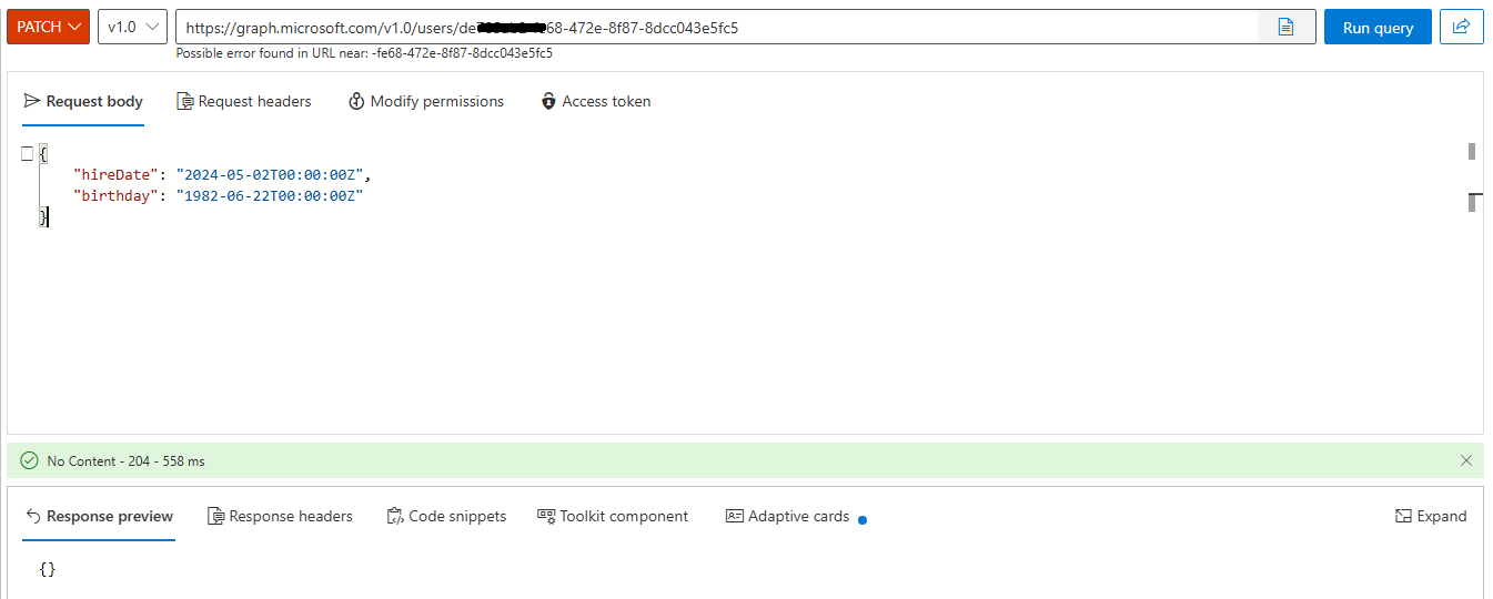

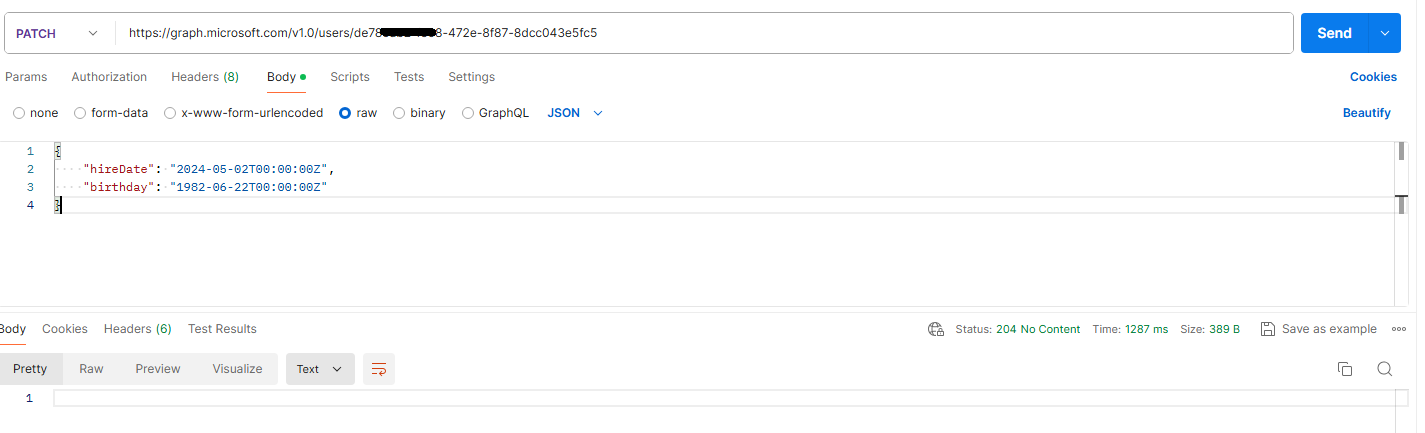

    Hi @Ajit Shanbhag
    Tested in Graph Explorer and Postman, it runs well and can successfully change the values of hireDate and birthday, the test results are as follows:
    Screenshot 2024-08-16 105715
    Screenshot 2024-08-16 025822
    You can refer to my test results to check, if there is no result, please share your error information, we will further study.
