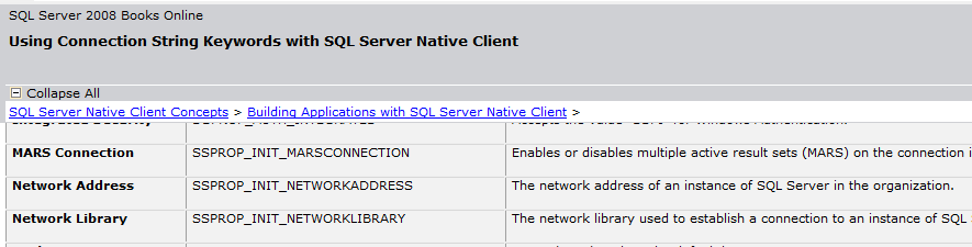

    v19 connection string:
    Provider=MSOLEDBSQL19;Trusted_Connection=yes;Server=xxxxxxxx;MARS Connection=True;Database=xxxxxxxx;DataTypeCompatibility=80;Use Encryption For Data=Optional;
    v18 connection string:
    Provider=MSOLEDBSQL;Trusted_Connection=yes;Server=xxxxxxxx;MultipleActiveResultsets=True;Database=xxxxxxxx;
