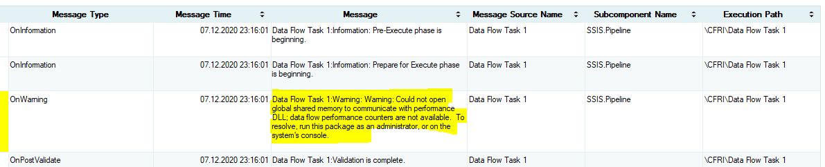

I have an issue with the SQL job that always fails when I am not logged in with remote connection with the SQL server with the user which is assigned to proxy user.
The job is executing a SSIS package that saves the file on the SQL server Location. The job creates the excel file, however not writing anything to it and fails.
It fails only in situation when I am not logged to server.
The job type is "SQL Server Integration Services Package"
Other job without task related to moving files are working fine.
Is this normal behavior? Is there a way to fix this? Hope this is enough information.

  3. Tom Phillips 17,781 Reputation points
    2020-12-08T20:01:17.357+00:00
    The screen shot you posted is only a warning, not an error. That did not cause the process to fail.
    The most common reason for what you describe is you are trying to write to a mapped drive. You need to use the full UNC path instead.
  4. Kamil 1 Reputation point
    2020-12-09T10:27:53.113+00:00
    I have the folder on C drive and so far I had path C:\FolderName when I changed it to UNC path: \Server01\C$\FolderName it failed with the following error:
    CFRI:Error: SSIS Error Code DTS_E_OLEDBERROR. An OLE DB error has occurred. Error code: 0x80004005.
    An OLE DB record is available. Source: "Microsoft Access Database Engine" Hresult: 0x80004005 Description: "The Microsoft Access database engine cannot open or write to the file '\Server01\C$\FolderName\File.xlsx'. It is already opened exclusively by another user, or you need permission to view and write its data.".
    And actually when I tried to run the job with path C:\FolderName what is happening is unexpected termination, without any specific error:
