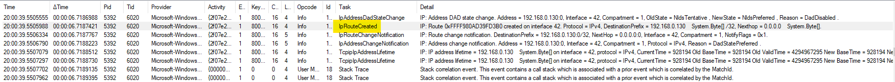

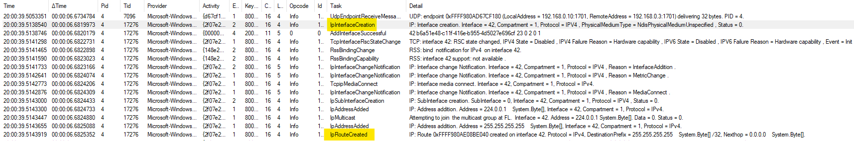

  1. Gary Nebbett 6,476 Reputation points
    2020-12-14T21:10:53.767+00:00
    Hello @Zachariah DeGraaf ,
    By way of illustration, this is an example of a route addition with an obvious cause:
    And this is an example of a route added by an application (the RasMan service, process ID 5392):
    The stack at this point looks like:
