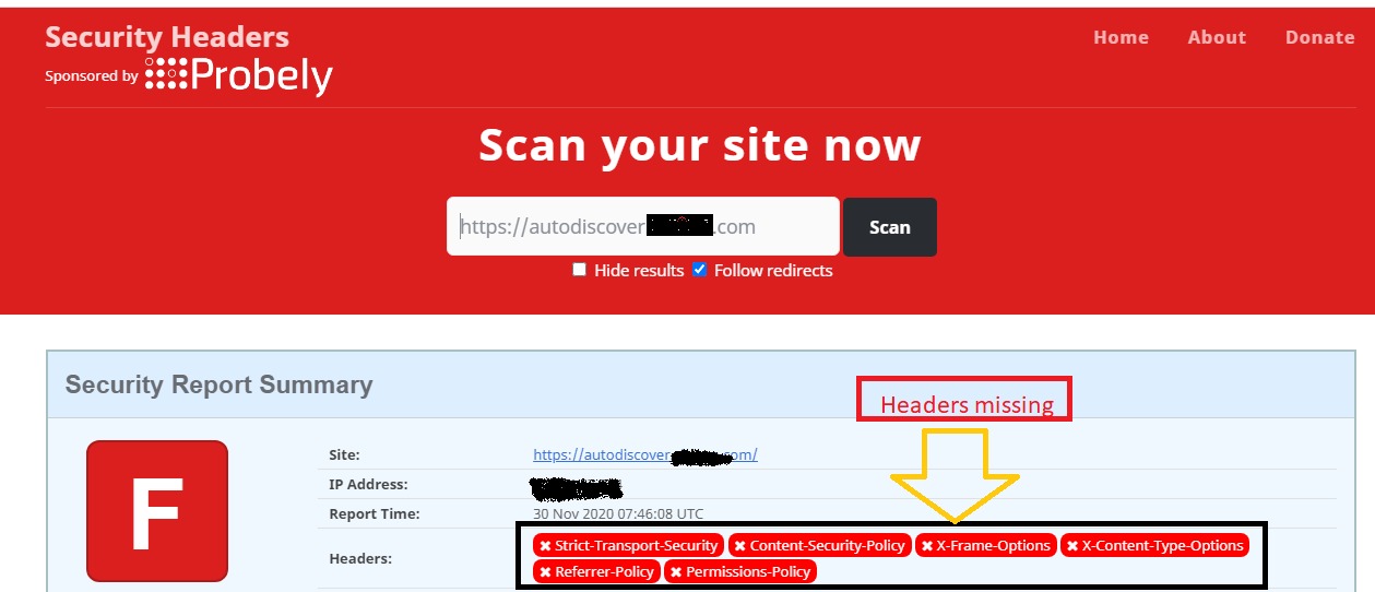

Our SOC team does random checks for any security issues and they tried to run a poodle scan using following website: https://securityheaders.com/
SOC team ran the test for autodiscover.domain.com and got an F rating. Attached is the screenshot for the same. IMG-20201130-WA0001.jpg
Now the issue is that SOC team want to make sure that the exchange server has strict security and should not get any web attacks and want it to be secured from hackers.

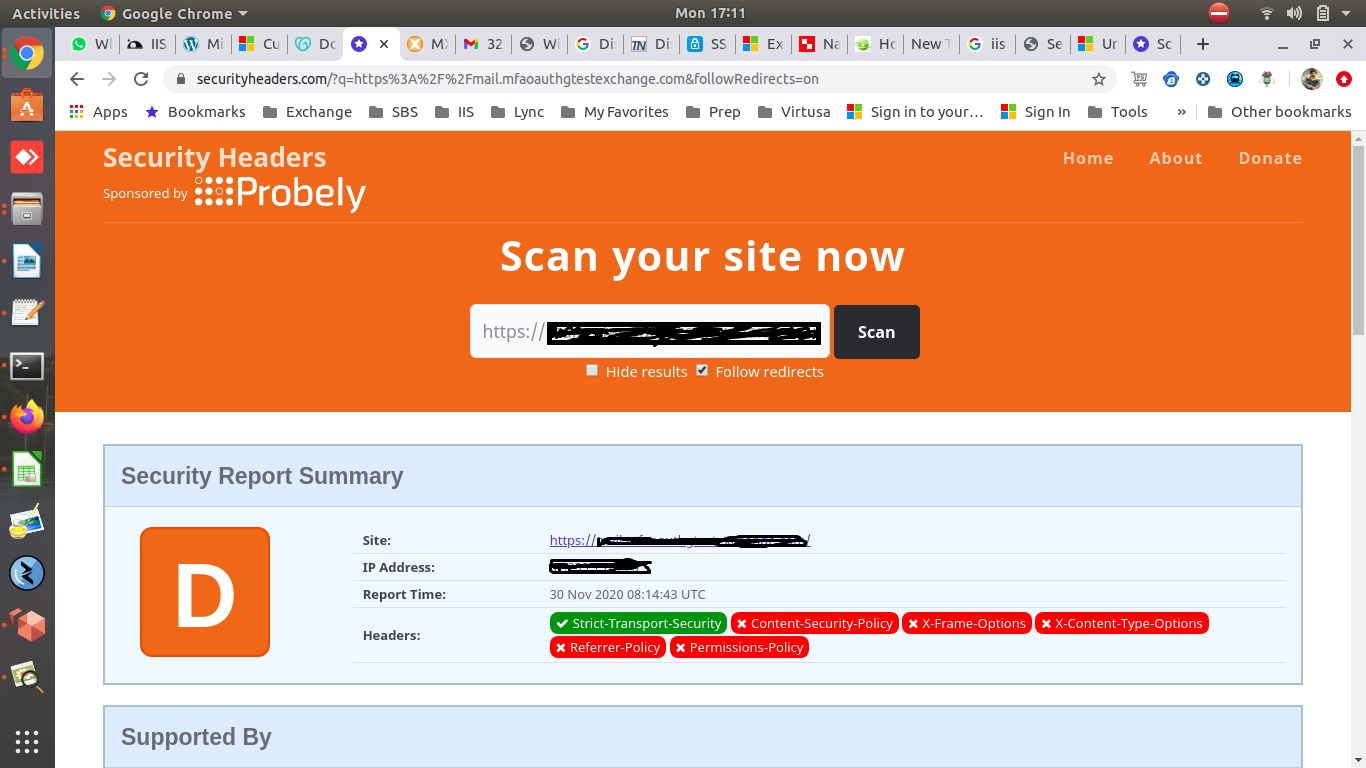

I enabled the IIS HTTP header to strict mode and ran the security test again which gave me a D rating (See Screenshot) Screenshot from 2020-11-30 17-11-27.jpg, but I cannot go further since if I use the web.config changes mentioned in below article it breaks ECP and OWA functionality.

    Personally, I think you don't need to worry about it.
    Firstly, we don't know the working mechanism and evaluation standard for the tool that you used.
    Secondly, Exchange doesn't use the "https://autodiscover.domain.com", the autodiscover works with "https://autodiscover.<smtp-address-domain>/autodiscover/autodiscover.xml". If you still think the autodiscover record isn't safety, you can remove this record and use SRV record to replace it.
    In fact, you can use many devices(Such as F5 or EOP) to filter client access requests to ensure the security of your Exchange server.
    If you are still concerned about the security of your Exchange server, you could open a paid ticket to confirm with Microsoft products team.
