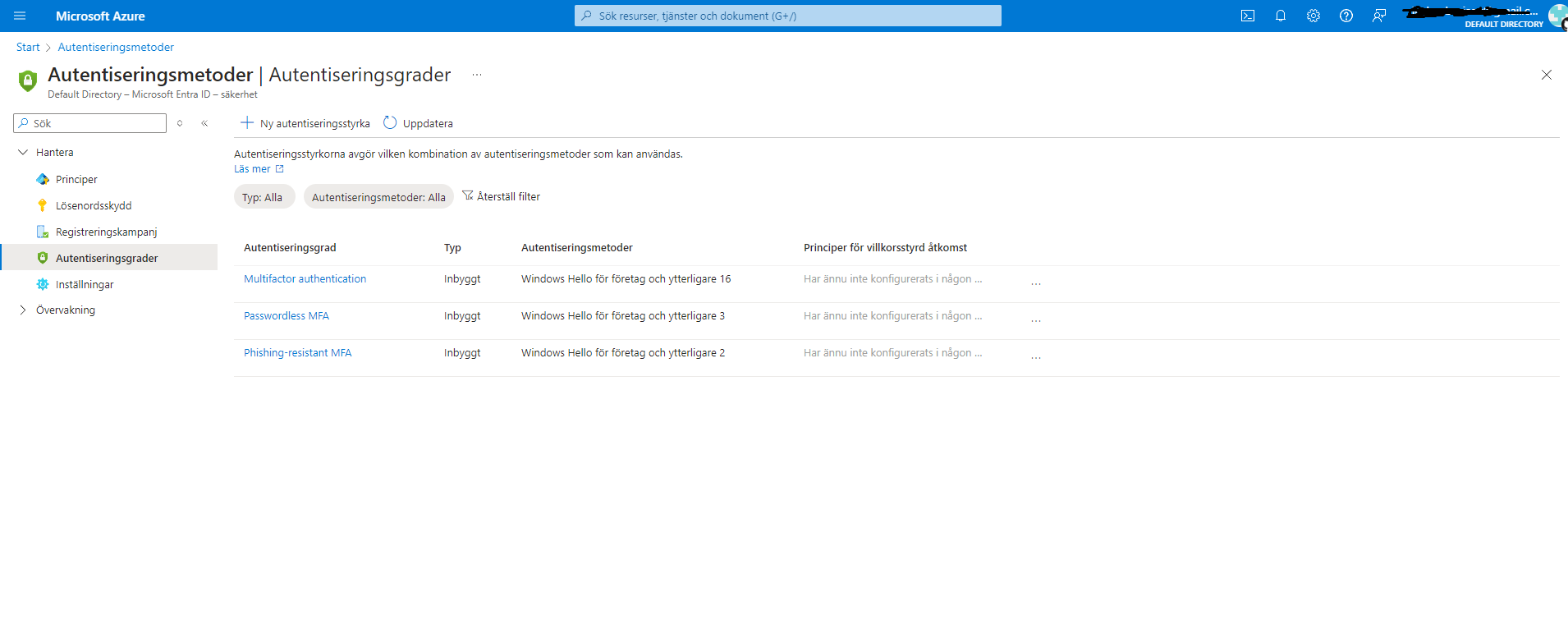

I attached a photo of what I think is done correctly. What I wonder is, is it now done? Do I need to do anything else?
Currently I am using all this for https://portal.azure.com/#home and I have some api:s running through it (I did nor code it or set it up) so that is why I am a bit confused here.
Once again, is it all done now? Do I need to do anything else? I do not want my api setups to stop working.

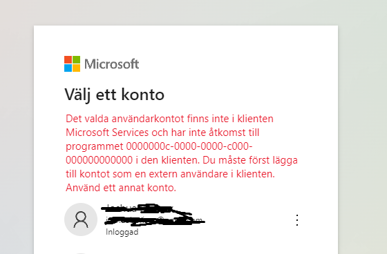

    As we discussed, you were trying to register for MFA using the https://mysignins.microsoft.com/security-info page but encountered an issue during login because your personal account is linked with your GitHub profile.
    To resolve this, we created another user account with global admin rights and tested whether you could register MFA methods with this new account. We successfully registered MFA for this user and made the necessary changes to your modern authentication method policies.

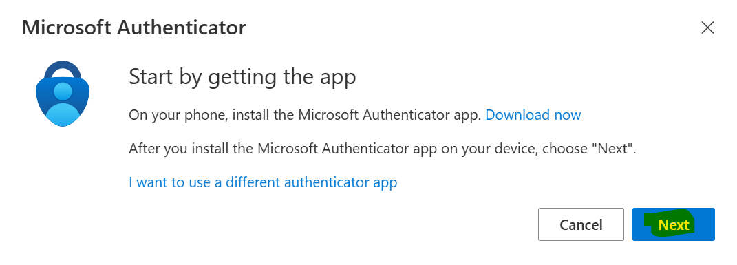

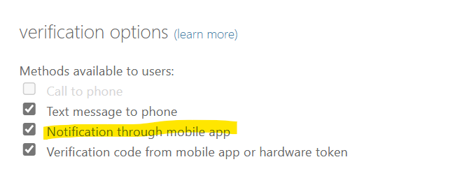

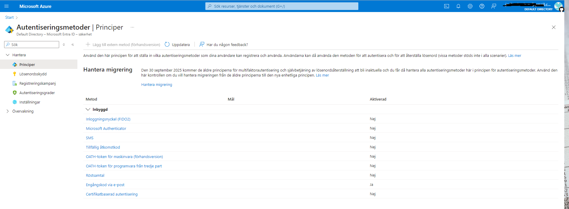

    We also unchecked all verification options from the legacy per-user MFA blade and completed the migration process. Afterward, we enabled the Microsoft Authenticator method in the Modern Authentication Method Policy blade.

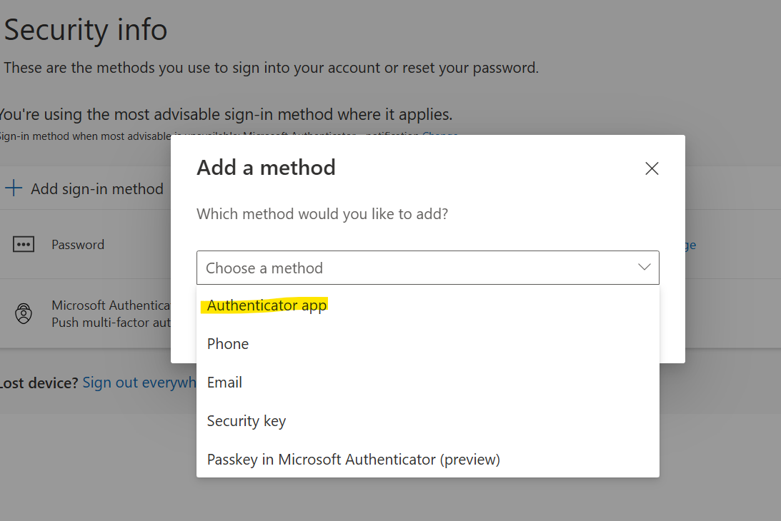

    For your personal account, we used the link https://myaccount.microsoft.com/?tenant=<tenant_ID> to force authentication and direct you to the correct directory by specifying the tenant ID. This allowed us to successfully log in to the security info page and register MFA.
