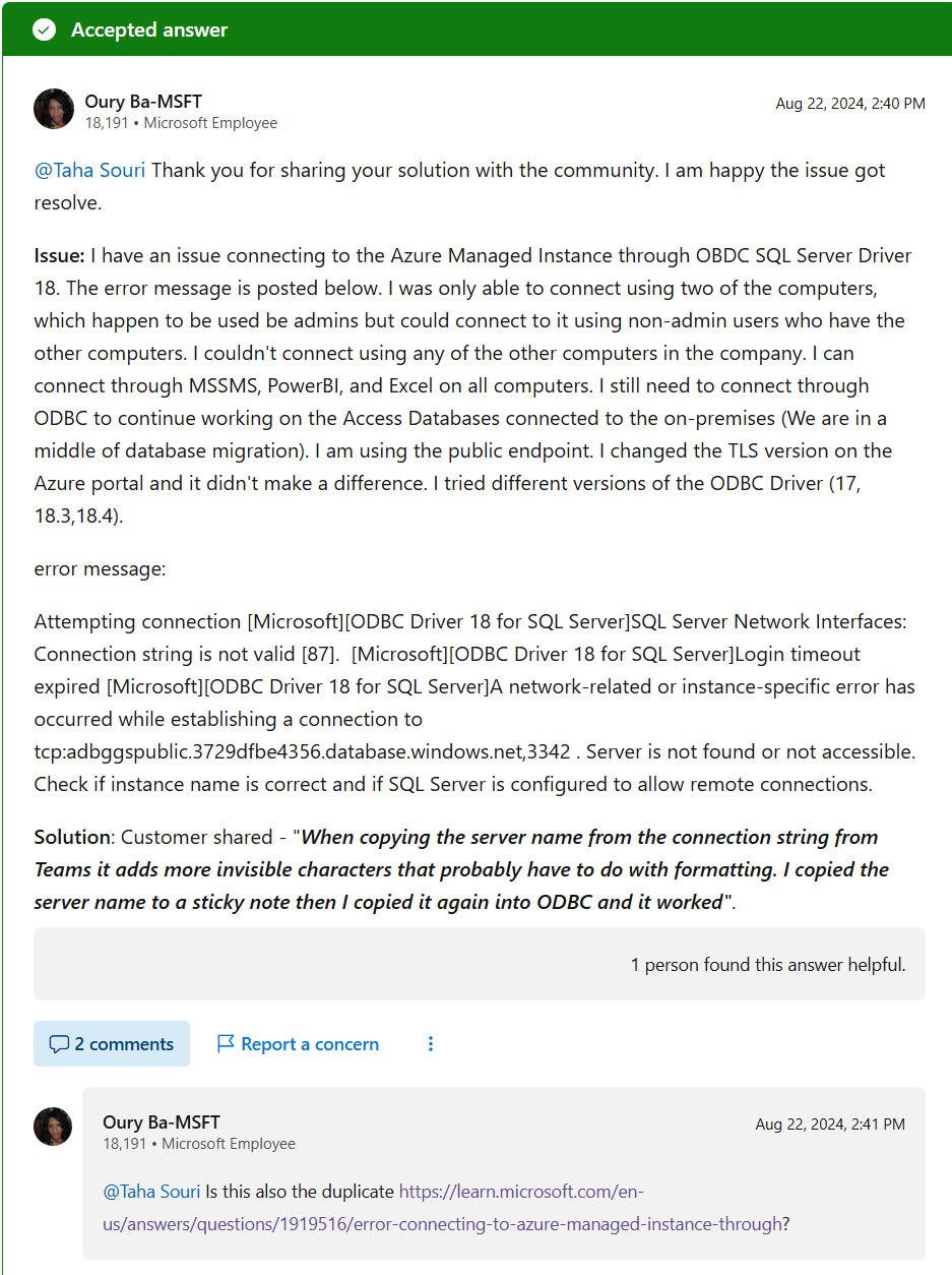

I am unable to connect to the Azure Managed Instance using the OBDC SQL Server Driver 18. The error message says the connection string is not valid [87]. I have tried different ODBC driver versions and changing the TLS version on Azure portal but it did not resolve the issue. I can connect through other tools like MSSMS and PowerBI. What might be causing this error? Update:
It was actually what suspected. When copying the server name from the connection string to Teams and then copying again from Teams it adds some invisible characters that probably have to do with formatting. I copied the server name to a sticky note then I copied it again into ODBC and it worked. It has certainly driven me crazy, but I am thankful that it was a simple mistake.
