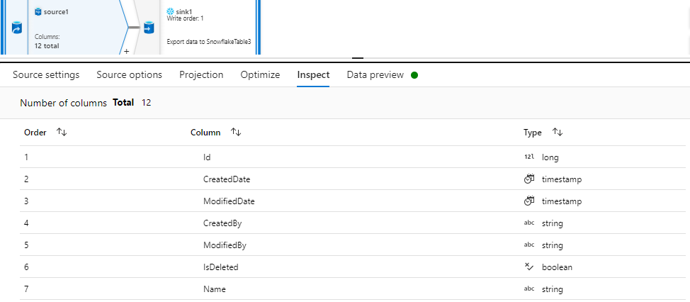

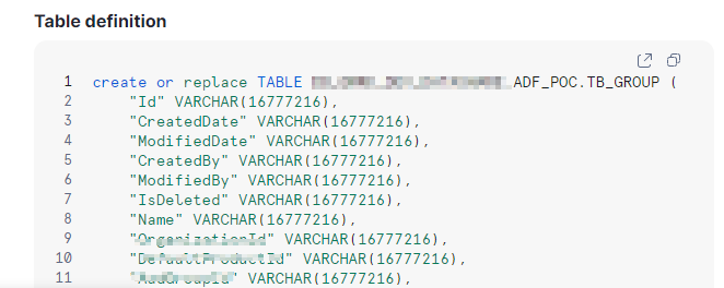

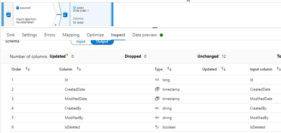

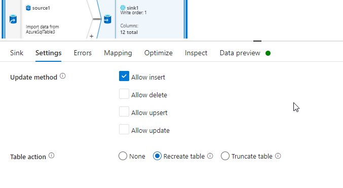

I am loading data from Azure sql Db to snowflake using data flow activity with infer schema at source and Recreate table at sink enabled , but table created at snowflake side is created with all column as string data type

    On the schema mapping, can you explicitly map the data types in your data flow activity and see if it helps?
