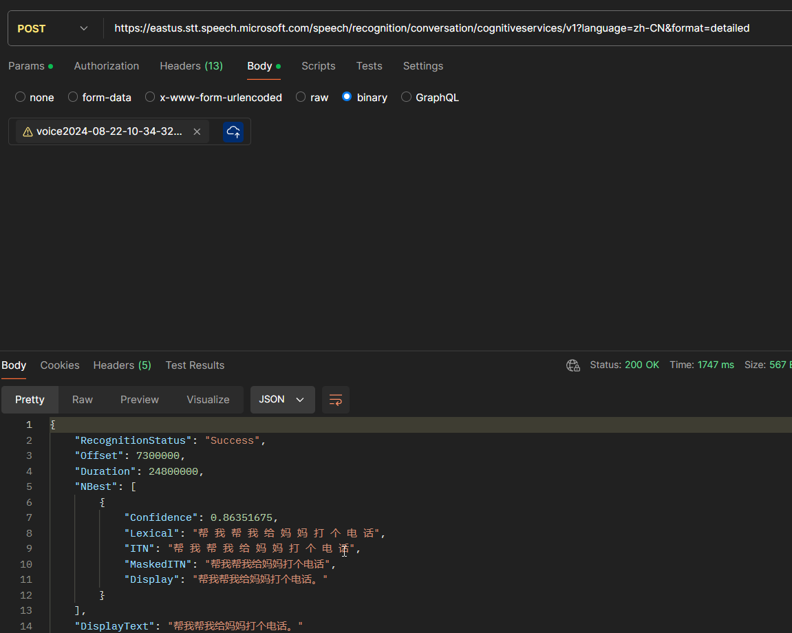

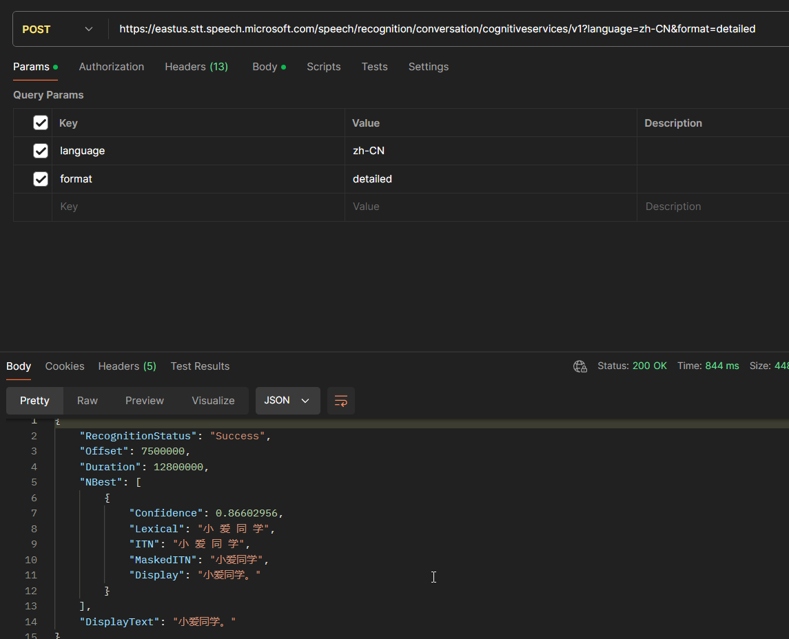

When using the REST API for short audio to text conversion, the official documentation requires 256kbps, but sometimes 128kbps can also be recognized.
When using the fast transcription REST API, no official documentation requiring a baud rate, I can recognize files using 128kbps.
My question is, are there minimum requirements for the speech baud rate of the two APIs mentioned above?
When using the REST API for short audio to text conversion, sometimes recognition can be achieved at 128kbps,xiaoaitongxue_low.txt, but sometimes the recognition result is empty without any error,voice2024-08-22-10-34-32.txt.ps:Please modify the file extension of the above two files to. wav

  1. romungi-MSFT 48,911 Reputation points Microsoft Employee Moderator
    2024-08-23T11:15:56.25+00:00
    @连博10335043 I just used the files with REST API and in both cases the audio was recognized. My resource is in eastus, maybe the documentation is not updated with respect to type of files supported by short audio. Here is a screenshot of the responses.
