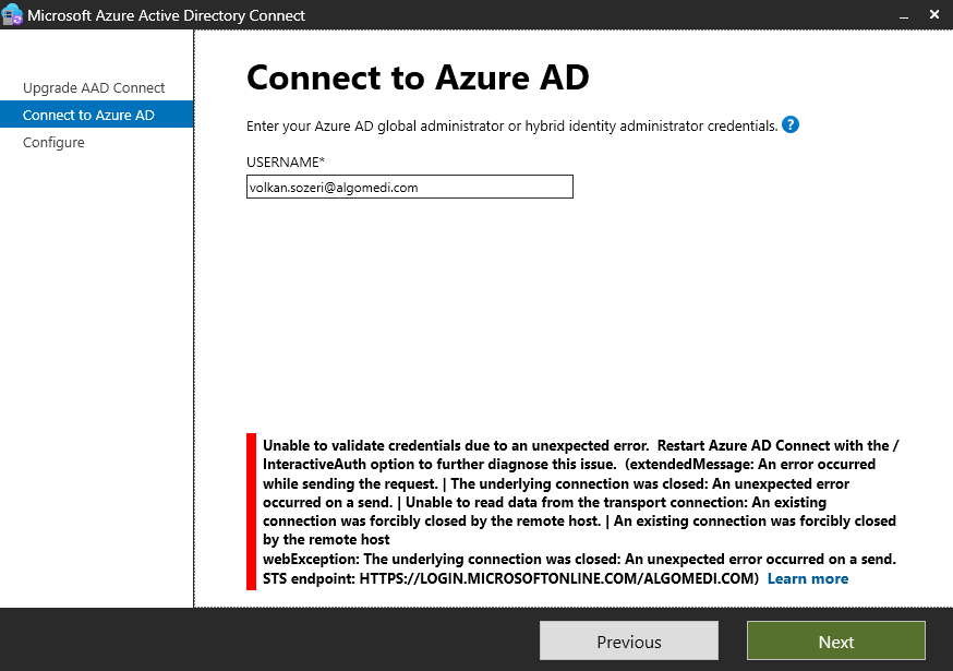

Hi everyone,
Error Information: Unable to validate credentials due to an unexpected error. Restart Azure AD Connect with the / InteractiveAuth option to further diagnose this issue. Unable to read data from the transport connection:An existing connection was forcibly closed by the remote host.
After I update Microsoft Entra ID and tryin to connect Azure AD
when I write my Administrator Account info and trying to login I see this error
I trying to this commands; open cmd
cd "C:\Program Files\Microsoft Azure Active Directory Connect"
AzureADConnect.exe /InteractiveAuth
Open this service and trying again but I got still Same Error
Can somebody help me?
Thanks alot
Kind regards

  1. Akhilesh Vallamkonda 15,345 Reputation points Moderator
    2024-08-26T10:36:53.1333333+00:00
    Hi @Volkan Sözeri
    Thank you for reaching Microsoft Q&A.
    I am sorry for the inconvenience you have faced while you are configuring the Entra connect.
    It might be issue with the TLS 1.2 is not enabled in the .NET framework
    Could you please run the below PowerShell script to enforce TLS 1.2.
    PowerShell script to enable TLS 1.2
    Before installing, please read and verify the Prerequisites for Microsoft Entra Connect.
    If your Hybrid Identity Administrators have MFA enabled, the URL https://secure.aadcdn.microsoftonline-p.com must be in the trusted sites list. You're prompted to add this site to the trusted sites list when you're prompted for an MFA challenge, and it hasn't been added before. You can use Internet Explorer to add it to your trusted sites.
    If the issue persists, please refer the below article
    Azure AD Connect – Unable to validate credentials due to an unexpected error.
    Hope this helps. Do let us know if you any further queries by responding in the comments section.
