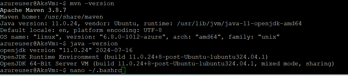

java and maven installed on linux agent and set environmental variables permanently still facing maven is not installed error
Suneel Kumar Boyapati 0 Reputation points
2024-08-22T11:54:22.9866667+00:00
Maven
View raw log
  1. Starting: Maven ============================================================================== Task : Maven Description : Build, test, and deploy with Apache Maven Version : 4.243.1 Author : Microsoft Corporation Help : https://docs.microsoft.com/azure/devops/pipelines/tasks/build/maven ============================================================================== Maven is not installed on the agent /usr/bin/mvn -version The JAVA_HOME environment variable is not defined correctly, this environment variable is needed to run this program. ##[error]Build failed. ##[error]Exit code 1 returned from process: file name '/home/azureuser/myagent/externals/node20_1/bin/node', arguments '"/home/azureuser/myagent/_work/_tasks/Maven_ac4ee482-65da-7b085873e532/4.243.1/maventask.js"'. Finishing: Maven

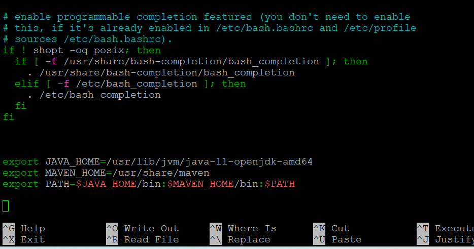

    Update Environment Variables: Add the following lines to your .bashrc or .bash_profile file to ensure the environment variables are correctly set:
    export MAVEN_HOME=/path/to/your/maven
    export PATH=$MAVEN_HOME/bin:$PATH
    Replace /path/to/your/maven with the actual path to your Maven installation. Then, run source ~/.bashrc to apply the changes.
