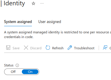

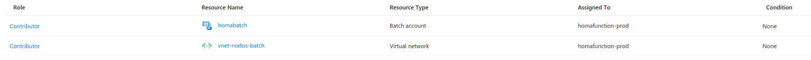

I have activated the "Identity" (System assigned) in Azure Function and I gave this identity the ROLE of "Contributor" in Azure Batch and also to the "vnet-nodes-batch".
The error I am getting is:
Error inesperado: 'DefaultAzureCredential' object has no attribute 'signed_session'
Try the managed identity and give the roles to batch and the vnet. I expected the function to create the node with the associated vnet.

    1.- my identity in azure function
    Captura desde 2024-08-26 16-07-00
    2.- my identity permissions in azure batch and vnet
    Captura desde 2024-08-26 16-09-23
