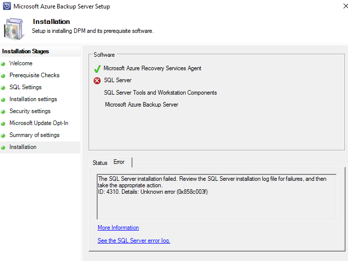

Exit error message: The /IACKNOWLEDGEENTCALLIMITS command line parameter is missing or has not been set to true. An Enterprise Server/CAL license product key (as opposed to Enterprise Core) was entered, and this computer has greater than 20 physical cores (40 logical cores with Hyper-threading enabled). This is a required parameter for the setup action you are executing to acknowledge that the SQL Engine will only utilize up to 20 physical cores, or 40 logical cores with Hyper-threading enabled.
Start time: 2024-08-22 16:14:03
End time: 2024-08-22 16:14:14
Requested action: Install

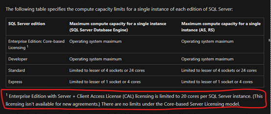

    @Sam Albright - Thank you for reaching out to the support, happy to assist you. MABS install Enterprise version for SQL server which has 20 core limit. Please find below the details. 1000000049
    So this limit is for SQL Licence which is shipped with MABS. You can either lower the cores of the server and try again installing MABS or you can use your own SQL Licence to install SQL and then install MABS application using the existing SQL instance.
