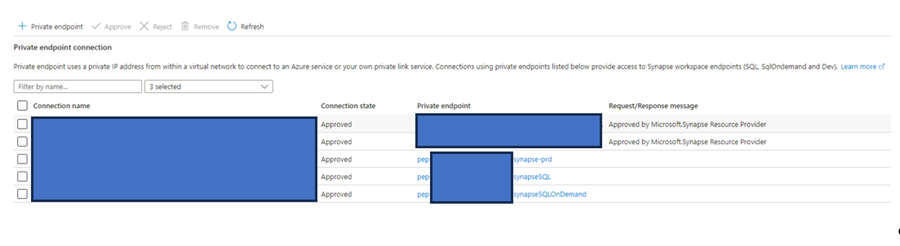

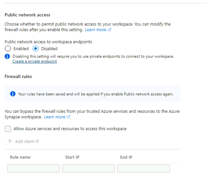

I got a 403 error when access my Synapse Workspace created in a managed virtual network within a jumphost inside my virtual network.
This is the network settings of my Synapse Analytics workspace
My bicep files have help me set up some private endpoints

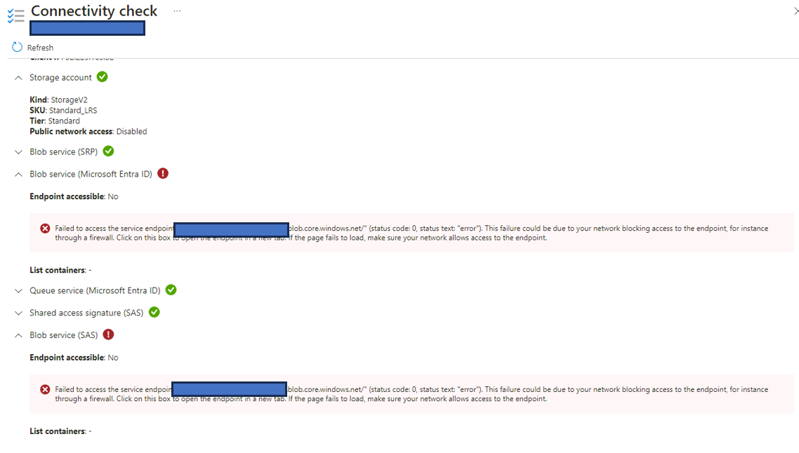

I have already added my Synapse Workspace as Contributor in my data lake storage account
I also got error when accessing my blob from within the jumphost
My goal is to allow all the Azure Services inside the same virtual network able to access the Synapse workspace and my Synapse workspace able to access the data lake storage account.
Does anyone know which part I have set up wrongly?

    1. Ensure that the private endpoints for your Synapse workspace are correctly set up.
    2. Check that the DNS configuration is correctly resolving the private endpoint.
    3. Verify that the Network Security Groups (NSGs) associated with your private endpoints allow inbound traffic from your IP address or subnet.
    4. Ensure that the firewall settings on your Synapse workspace are correctly configured to allow access from your private endpoints.
