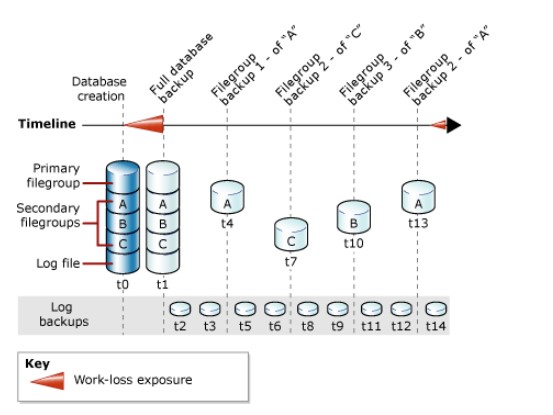

    File Backup: The files in a SQL Server database can be backed up and restored individually. Using file backups can increase the speed of recovery by letting you restore only damaged files, without restoring the rest of the database. For example, if a database consists of several files that are located on different disks and one disk fails, only the file on the failed disk has to be restored. The damaged file can be quickly restored, and recovery is faster than it would be for an entire database.
    Full file backup: A full file backup backs up all the data in one or more files or filegroups. By default, file backups contain enough log records to roll forward the file to the end of the backup operation. Under the full recovery model, a complete set of full file backups, together with enough log backups to span all the file backups, is the equivalent of a full database backup. Below screenshot makes you better understand this. Please refer to MS document Full File Backups (SQL Server).
