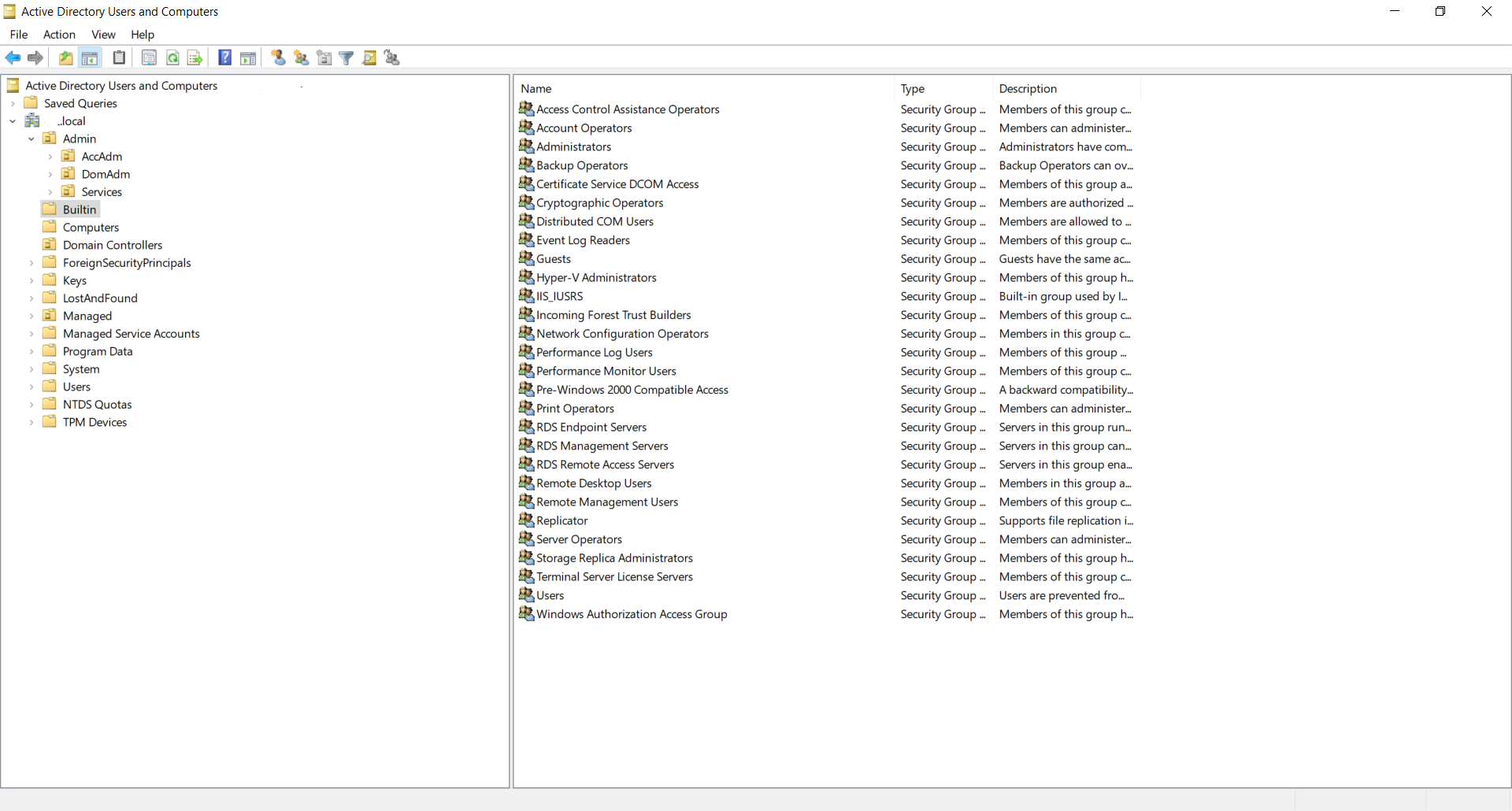

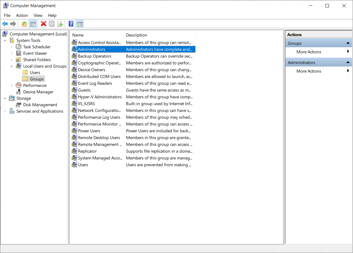

  2. Andrew Peel 1 Reputation point
    2020-12-26T19:54:54.783+00:00
    The root cause of the issue was “Authenticated Users” being in the local administrators group of the device. Removing “Authenticated Users” from the local administrators group resolved the issue.
