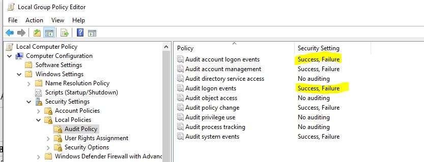

    Run gpedit.msc and check to see that both success and failure is enabled for logon events. When your backup runs, you should see a logon event for whatever backup account you used.

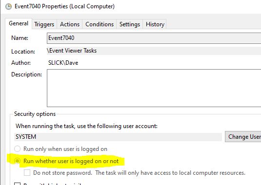

    If it's the Windows task scheduler, just run compmgmt.msc and change the task definition to "Run whether the user is logged on or not". You will need to enter the users password when you do that.

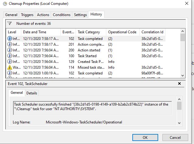

    Look in the history log of the task. Did it run or not? Does the process that the task runs create a log file anywhere? You may need to enable "all tasks history".
