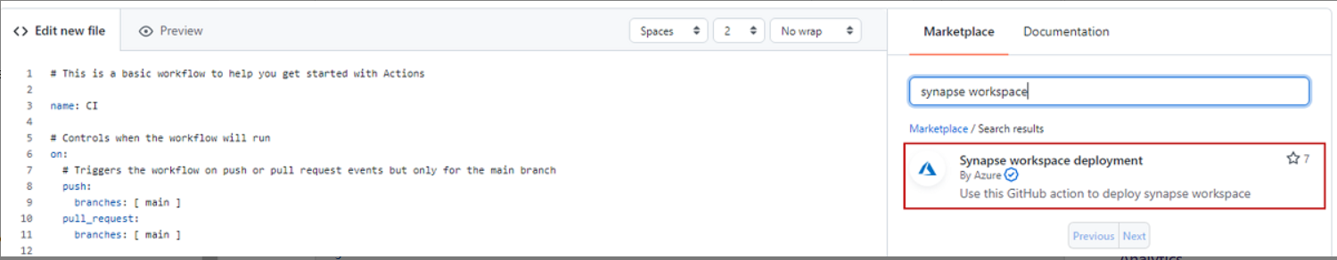

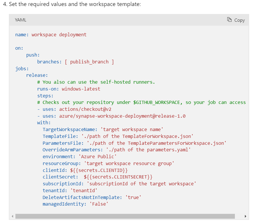

    Yes! You can configure Continuous Integration (CI) and Continuous Deployment (CD) workflows using GitHub Actions without relying on Azure DevOps. Infact, you can:
    1. Create workflows in your GitHub repository using YAML files. These workflows can automatically build, test, and deploy your code based on triggers (such as pushes, pull requests, or scheduled events).
    2. Use GitHub Actions to automate the deployment process.
    3. Define environment-specific variables (secrets) in GitHub repository settings or use GitHub secrets.
    4. Store sensitive information (such as connection strings, API keys) securely using GitHub secrets.
    Check the links below for more detailed instructions:
