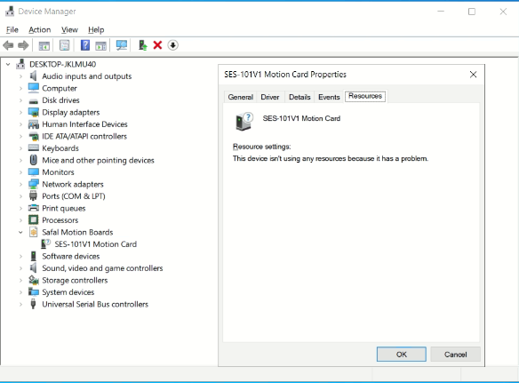

Under Resources settings an error message ' This device isn´t using any resources because it has a problem.' appears and no memory mapped or interrupt setting.

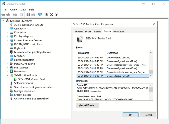

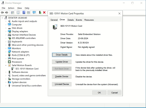

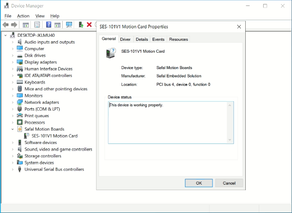

tela1
tela2
tela3
tela4
