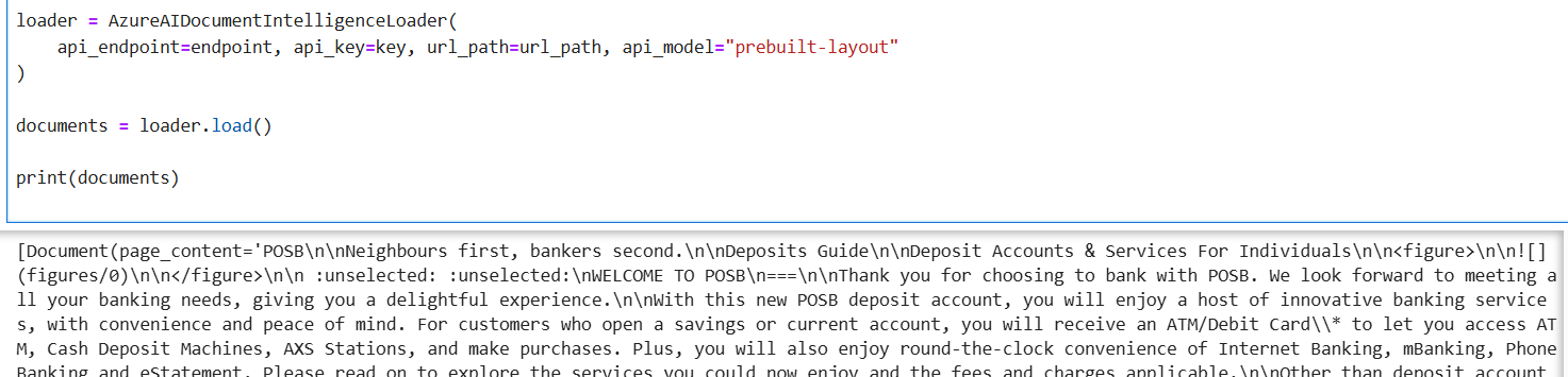

    Thank you for reaching out. The 404 Not Found error you're encountering when using the AzureAIDocumentIntelligenceLoader in LangChain typically suggests that the requested resource could not be found. This could be due to an incorrect API endpoint or model name, an inaccessible document URL, or a misconfiguration in your Azure Cognitive Services account. Please double-check that your endpoint URL and API key are correct.
    I tried to reproduce the issue with the provided code and was able to successfully extract the document. To ensure proper functionality, please make sure to install the necessary packages correctly. You should first install LangChain and Azure Form Recognizer using the following commands:
    pip install langchain
    pip install langchain-community azure-ai-formrecognizer
    See output:
