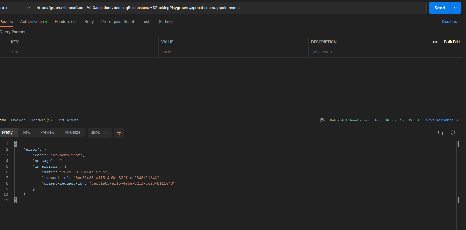

Hi Support team
I get access token by:
https://login.microsoftonline.com/7894512c-f554-4de4-bff2-dec418150d4c/oauth2/v2.0/token
Then call https://graph.microsoft.com/v1.0/solutions/bookingBusinesses/******@pricefx.com/appointments
The response is
    "error": {
        "code": "UnknownError",
        "message": "",
        "innerError": {
            "date": "2024-08-28T04:16:54",
            "request-id": "3ec31e83-eff5-4e5e-82ff-cc2348f11643",
            "client-request-id": "3ec31e83-eff5-4e5e-82ff-cc2348f11643"

    Hi @Hung Bui
    According to your error message, the error is caused by the token. Please follow the process of auth code flow to obtain the token. When obtaining the token, the user needs to interactively log in and authorize, otherwise, error 401 will be reported.
    The permission you need to grant when getting the token is Bookings.Read.All, which needs to be listed in the scope parameter.
    In addition, the List appointments endpoint also supports the use of application permissions, and when you use application permissions, you need to obtain the token according to the client credentials flow.

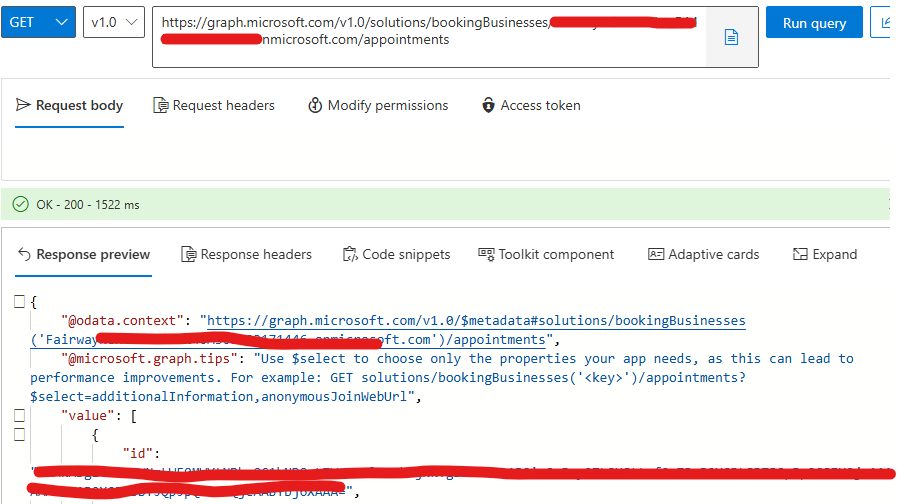

    It looks like you’re encountering an “UnknownError” when trying to list all bookings using the Microsoft Graph API. Here are a few steps you can take to troubleshoot this issue:
    1. Check Permissions: Ensure that the access token you’re using has the necessary permissions to access the bookings. You might need permissions like Bookings.Read.All, BookingsAppointment.ReadWrite.All , Bookings.Manage.All and Bookings.ReadWrite.All.
    2. Validate Access Token: Use a tool like jwt.io to decode your access token and verify that it contains the correct scopes.
    3. API Endpoint: Double-check the API endpoint URL to ensure it’s correct and that the booking business ID (******@pricefx.com) is accurate. List all Booking Appointments: To list all the Booking Appointments, you can use below Graph API endpoint. Please check documentation.
    GET https://graph.microsoft.com/v1.0/solutions/bookingBusinesses/{id}/appointments

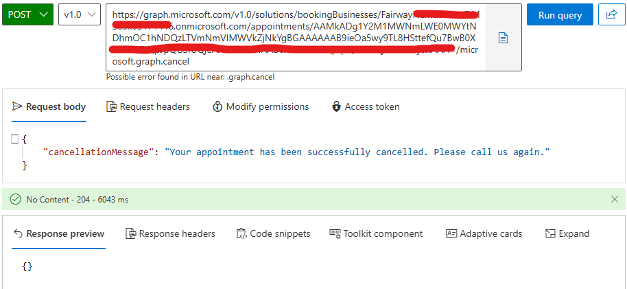

    Cancel a Booking Appointment: To cancel a Booking Appointment, you can use below Graph API endpoint. Please check documentation.
    POST https://graph.microsoft.com/v1.0/solutions/bookingBusinesses/{id}/appointments/{id}/cancel
    Content-type: application/json
      "cancellationMessage": "Your appointment has been successfully cancelled. Please call us again."
